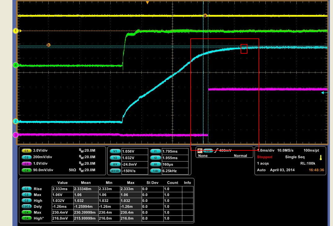

Hi, team,
I need to check one thing about TPS54318. Is there any PWRGD delay time of TPS54318? Or once the VSENSE voltage rises to the good condition above 93%, PWRGD MOSFET will turn off and pin voltage will turn high?
Thanks.
Waveform please refer to as below.
CH1:Vin  CH2:Vout  CH3: PWRGD  CH4:Iout
PWRGD is pulled up to Vin.
