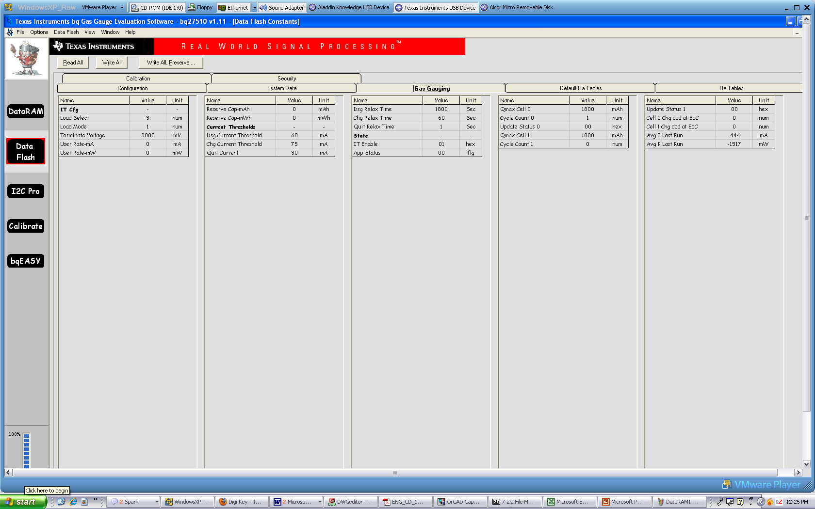

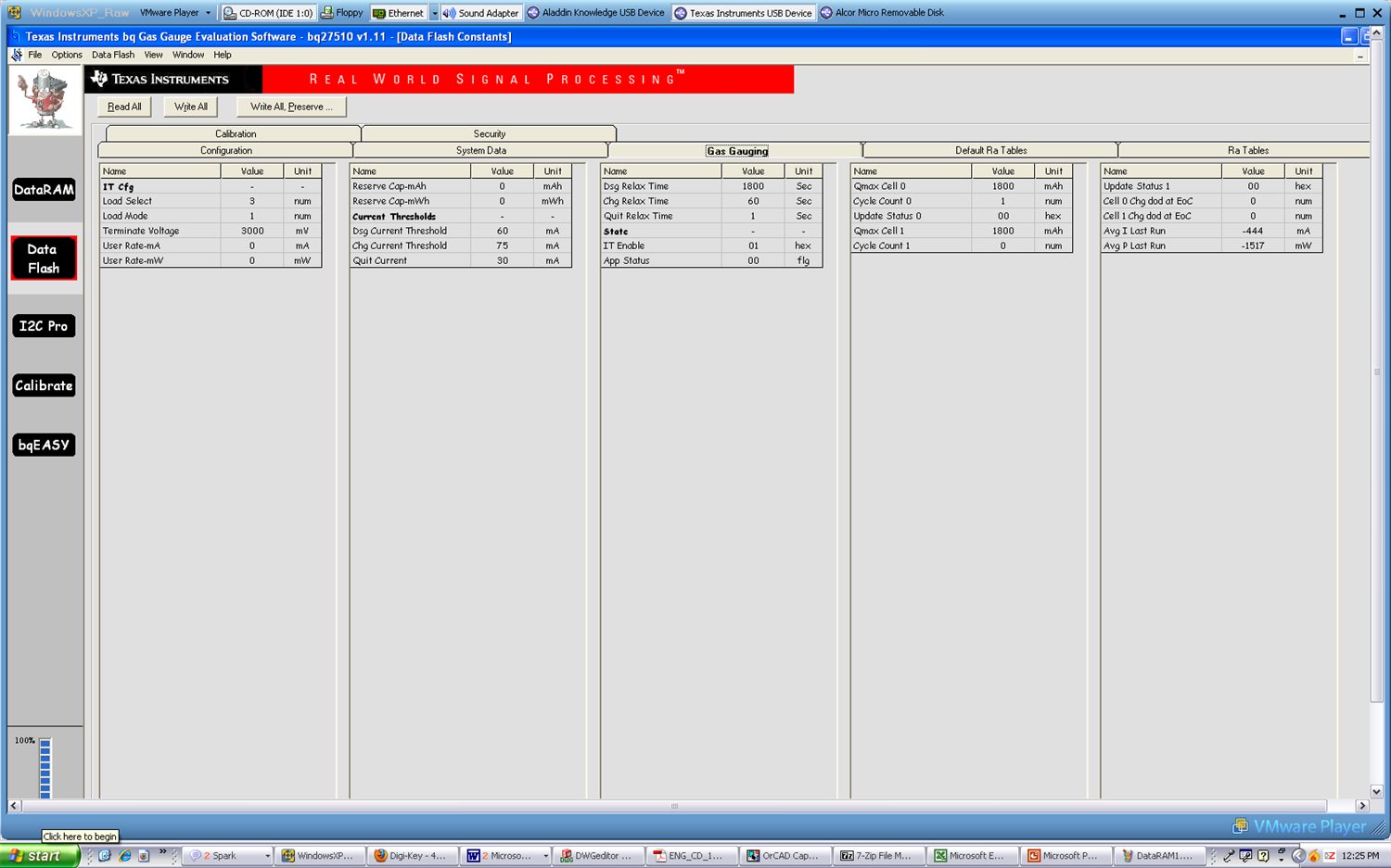

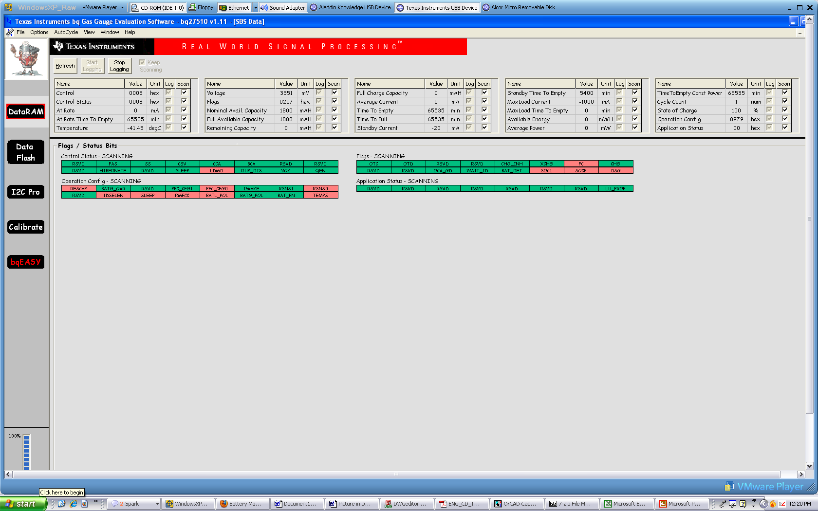

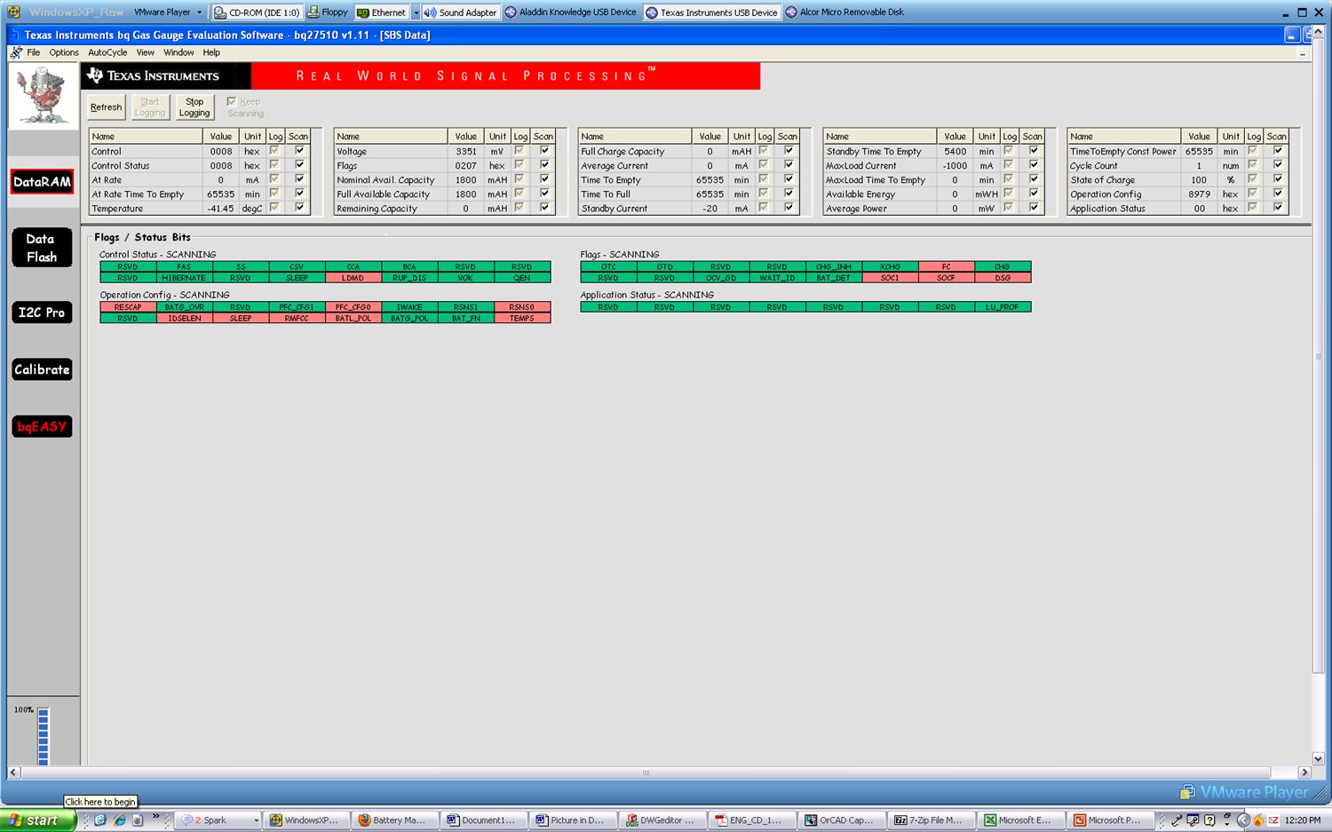

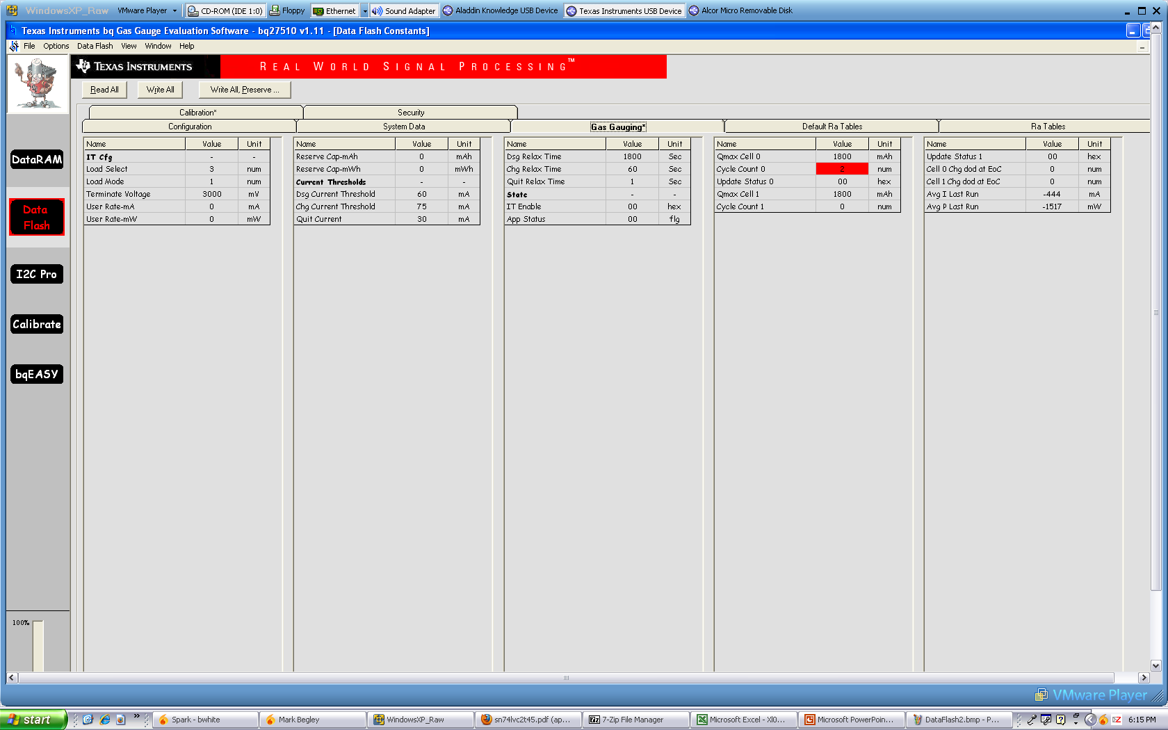

  • Hello David,
    Thanks for getting back to me I appreciate it. So these screens were taken during the relax period before I clicked Initialize IT. The battery is not connected to either the charger or resistor load. I disconnected it from the load when the voltage level reached 3V, but since then it has climbed back up, which you mentioned in your last message. I noticed the FC bit was red which was a good sign at this stage, although I dont know if the CHG and DSG bits are what they should be. I would guess that a green CHG bit would mean the system thinks the battery is charging, but I could be wrong. I also looked at the Taper Current level and noticed that it was set at around 1300mA. Im pretty sure this is the charging the current of the battery, so I guess the current should always drop below this as it reaches its full capacity. Should I try and observe the current as the battery charges so that the taper current level is closer to what the actual cutoff is? I am using a charging circuit board as opposed to a power supply so I would need to rig an ammeter to check this. Hopefully everything looks good here, you helped clear up a lot of things already so I feel like im at least moving in the right direction. Thank you!
    -Bryan
  • Hi Bryan,
    I see a couple of problems if this is your starting point before you start your learning cycle.
    First, IT Enable in Data Flash is already set to 01.  This is probably because you tried and failed a learning cycle, but never re-initialized it to 00.  Go ahead and click on "01", type "00" and hit the enter key to rewrite it to 00.  The safest way would actually be to go through bqEASY again, but I think this will get you going.
    Now, I also noticed that your temperature is -41.45C.  It looks like you haven't calibrated temperature or you removed the thermistor.  If the gauge thinks this is the temperature it will fail to learn because everything will be disqualified due to the extreme temperature.  You must let it learn at nominal temperature, and if it thinks the temperature is otherwise then it will not work.
    If these screenshots are taken after you discharged the battery, then it doesn't make sense that your FC bit is set (red).  You shouldn't see FC set until you fully charge the battery!  If you really have Taper Current set to 1300mA then that's probably the reason.  That is an unreasonable value for your battery size.  Click on it and type in 130mA (just to be conservative), then hit enter.  This is assuming that your charger quits charging when the current drops below 130mA.  Chargers usually stop at 100mA or less, which is why 130mA is a reasonable setting, but you might want to tighten it down if you figure out your charger's actual quit current.

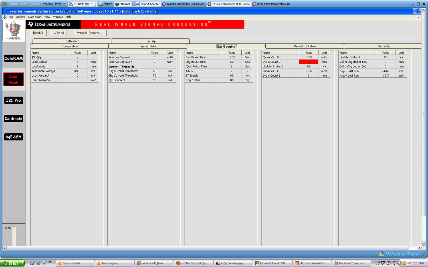

  • Hey David,
    So I fixed the temperature issue, turns out the thermistor wasn't connected properly, so now it reads a temp of about 23-26 degrees C, which is much more realistic, and within the temp range of the software. I also changed the taper current level to 130mA like you suggested, as well as manually reset the IT Enable Bit which seemed to fix the FC bit. Sorry I guess I read that one backwards before haha. These screens were taken right after I disconnected the load before the IT was initialized, similar to the when I took the screens from my last message. The only thing I noticed that I thought was unusual was that both the CHG and DSG bit were set while the battery was discharging. Also is it normal that the cycle count value is set to 2? This is the first time ive seen this value change.

  • Hi Bryan,
    First off, I just noticed that your firmware version appears to be bq27510 (v1.11).  This is our original bq27510 firmware version (and still ships on our EVMs), but we've released bq27510-G1 (v1.12).  Before you start your learning cycle and create your golden DFI, and assuming you want to use the latest and greatest in your production system, I recommend that you upgrade your EVM to bq27510-G1 (v1.12) in three steps:
    1. Install the new EVSW: http://focus.ti.com/docs/prod/folders/print/bq27510-g1.html#toolssoftware
    2. Download the v1.12 SENC file from the same section.
    3. Follow the instructions in this app note to program the new SENC into your EVM: http://www.ti.com/litv/pdf/slua453a
    Cycle Count increments every time the gauge counts enough discharging coulombs to equal the data flash parameter CC Threshold.  Since you've been messing with this EVM for a while without restoring the data flash, it's pretty likely that Cycle Count would have incremented by now.  :)
    Well, it looks like you are all set for a successful learning cycle now (although something can always jump up and bite you).  Hey, that's how we learn, right?  :)
    What I recommend, to keep everything clean and smooth, is to upgrade your EVM to v1.12, start bqEASY from the beginning so all your settings are reset, and go from there.  Let me know how it goes.

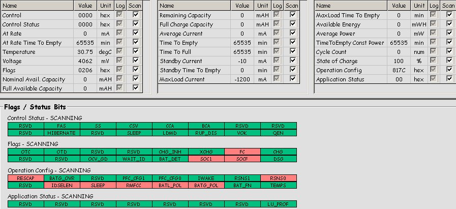

  • It's normal for the RUP_DIS bit to be set until you enable IT.  Unless the IT algorithm is running, updates to the resistance tables will not occur, and this is what RUP_DIS (R updates disabled) indicates.
    Can you confirm that RUP_DIS is cleared (green) after you enable IT, but the VOK and QEN bits are set (red).  This should be the condition after you enable IT, and before you start your charging.

  •  ...another day over, another day hoping in vain. The flags VOK and QEN keep staying zero.
    Unless you can point out a reason in my configuration, I'm giving up. I now understand, why competitors advertise their component with "no training cycle needed"...
    Please email a configuration, that you think will work for my battery data. I'm willing to test everything, if there is a realistic chance, the counter will finally go upwards.
    Regards, Phil
  • hi Phil,
    The screen shot you attached has show VOK and QEN bits are not set. Have you sent IT enable command?
    I assume you already went through the app note: http://focus.ti.com/lit/an/slua544/slua544.pdf  on how to generate golden image. No training cycle gauge is low end gauge and will not provide the high accuracy unless you want to go that route. If you can attach your gg file I will be happy to take a look. We have many customers who decided to use TI gauge for the best performance they are looking for.
    Ming
  • Hello Ming,
     I can see, those bits are not set. The key question is: why not? Of course, I have sent the IT command on the BQeasy.
    Are you sure, I should include the logfile in this post? I've been logging the whole day and it is LONG. Maybe you can contact me by email, so I can send you the logfile that way.
    Yes, I have read that app note. However, it still leaves my questions open.
    I'm amongst the customers, who decided to use a TI gas gauge in order to get best perfomance - that's, why I have it on my PCB now. However, I'm not convinced, this was a good decision...
    Regards, Phil
