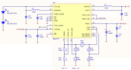

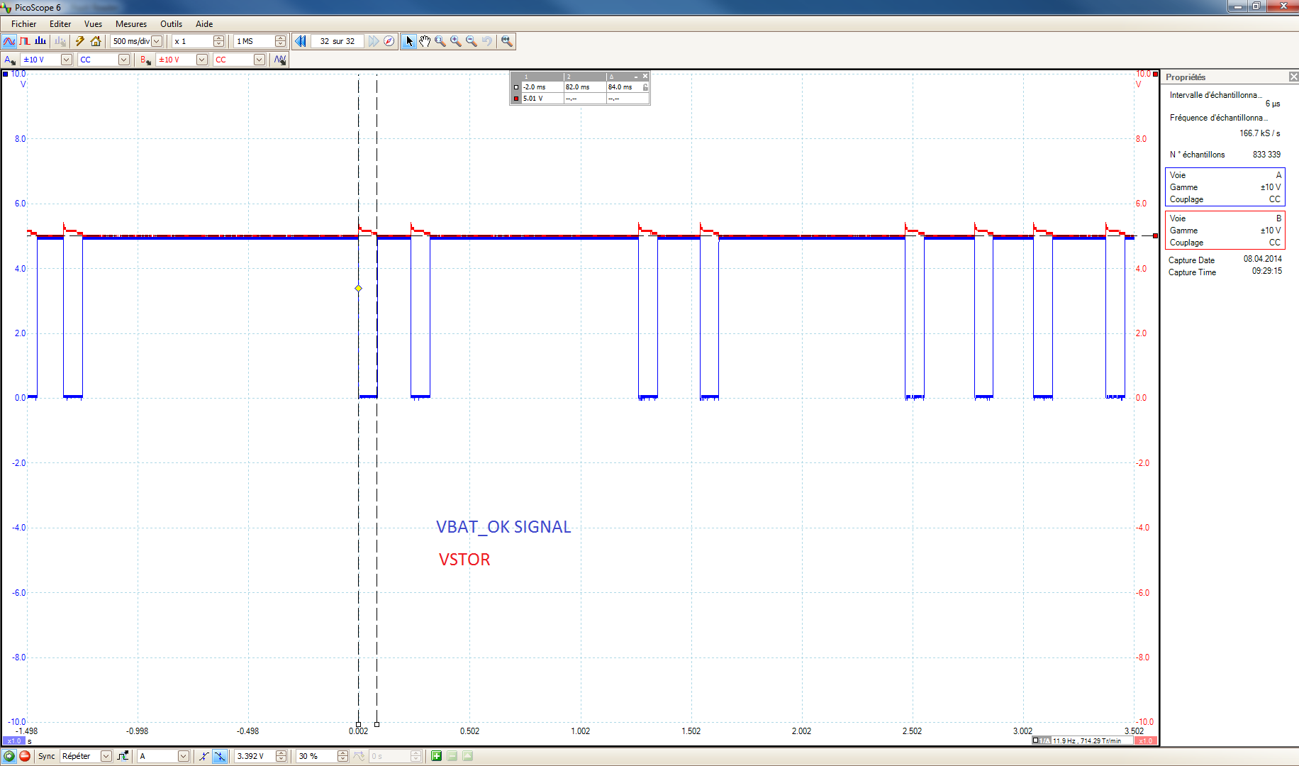

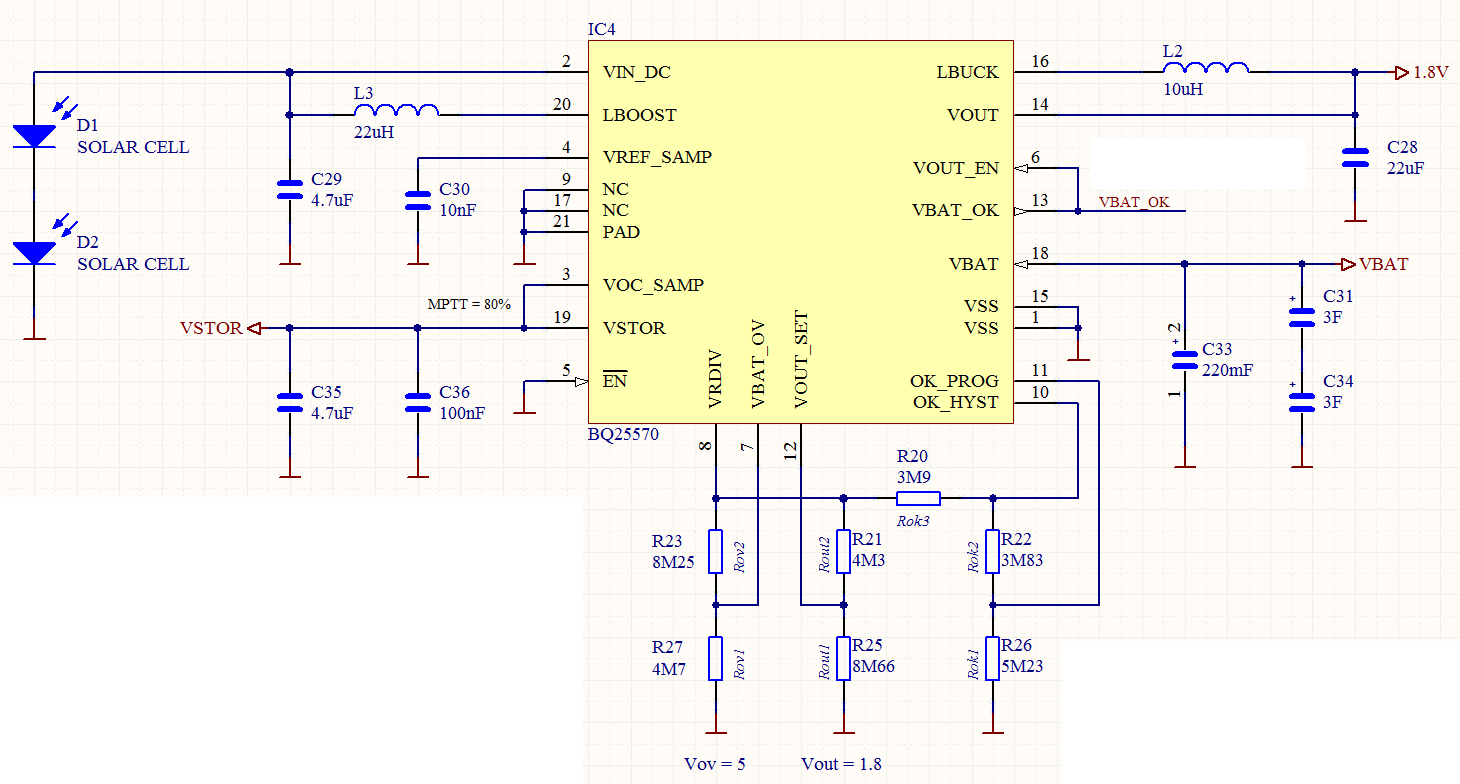

I am using a BQ25570 (Figure 1), and I have a problem with VBAT_OK digital signal.
I set VBAT_OK at the following thresholds :
VBAT_OK_HYST = 3.0V
VBAT_OK_PROG = 2.1V

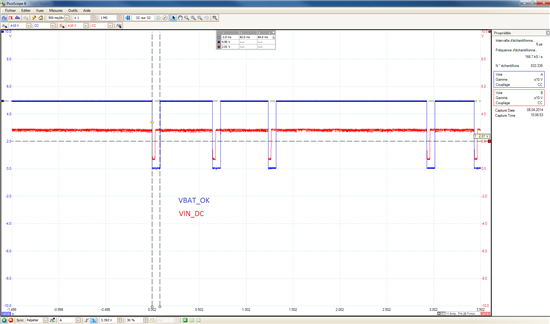

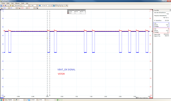

VBAT_OK, is toggled correctly at the threshold points, but when the VSTOR reach the maximum VBAT_OV (Set to 5.0V). VBAT_OK signal start to have a strange behaviour, in fact, VBAT_OK toggles randomly (Oscillogram 1). It appends only when solar cells are lighted, this mean only when the system is charging.
On the oscillogram, VBAT is not shown but VBAT is stable,but not VSTOR. We can see, that VSTOR signal peak to 5.4V.
BQ25570's datasheet explains VBAT_OK digital signal operation, maybe I miss something, but I didn't expect this kind of behavior.
Datasheet mention that BQ25570 does a "short-circuit" on VIN_DC in case if VIN_DC > VSTOR and VSTOR == VBAT_OV. (Oscillogram 2) show VBAT_OK and VIN_DC. I think is not what append in my case, because VIN_DC is never higher than VIN_DC.

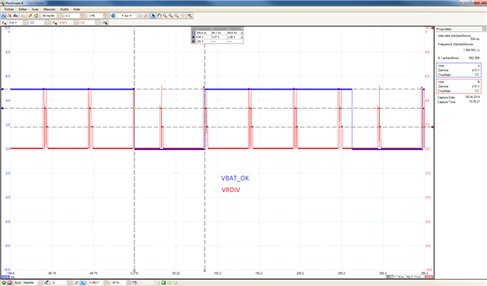

It may be the threshold which does not work properly, so I have done a measurement (Oscillogram 3) : Show VBAT_OK and VRDIV (PIN 8). I don't know why VRDIV signal behave different when VBAT_OK toggle low.

  • This is not expected.  To clarify one point, VBAT_OK monitors VSTOR not VBAT.
    What is the loading on VSTOR and VOUT?
    Does this happen on every board/IC or just one board?
    Does the same thing happen on a TI EVM?
  • Can you retake an oscope plot with VIN_DC, VBAT_OK, VSTOR and VRDIV on the same plot?
  • How well was your board cleaned of flux?  When I modified my first EVM to match your circuit, I didn't see the problem but when I modified a second EVM and didn't clean off the flux as well, I see a similar problem (VSTOR overshoots and BATOK drops out momentarily).  If I blow on the board, the problem gets worse (does it more frequently) due to the mositure in my breath.  There is a warning in the datasheet about how residual flux can form parasitic resistors/capacitors that resize the >1Mohm voltage setting resistors.  Can you try re-cleaning the board?  If that doesn't work, then reduce the size of your resistors by a factor of 100 and see if you still have the problem (assuming your input source can supply the current for those resistors).

    Solar cell characteristic : Voc = 1.8V, Icc = 15mA
    C31 and C34 are not mounted.
    C33 : 220mF, Rs = 25 Ohm

    5) Size of your resistors by a factor of 100 and see if you still have the problem (assuming your input source can supply the current for those resistors).
    Do you mean change R23/R27, R21/R25, R20/R22/R26? The datasheet recommend a value range of MIN=11Mohm to MAX=15Mohm.
    I don't understand exactly why a minimum is required, but I'll do the modifications on Friday to verify if the problem still persist.
    I observed that the problem occured only when VSTOR > ~4.5V.
    This mean that the system do not need to be charged at VBAT_OV to start toggling but it must need to be lighted to toggle. If I set VBAT_OV to 4.3V, VBAT_OK work properly.

    Regarding 4, most board manufacturers are not accustomed to cleaning boards with resistors >>1M.  When developing the TI EVMs, I had to prove to my EVM supplier that they needed to perform a special cleaning to remove parasitic resistors.
    Regarding 5, I was not clear.  I meant to suggest that you lower your resistors by a factor of 100 (i.e., instead of 1Mohm you use 10kohm).  Parasitic resistors formed by solder flux are in the 1Mohm+ range.  If your resistors are smaller, the parasitic flux resistors will not have an effect and that will prove my theory.

    Regarding to my schematic, I changed resistors values to a factor 10 (Circuit C).
    R23 = 820k
    R27 = 470k
    R20 = 390k
    R22 = 390k
    R26 = 570k
    Always the same problem.

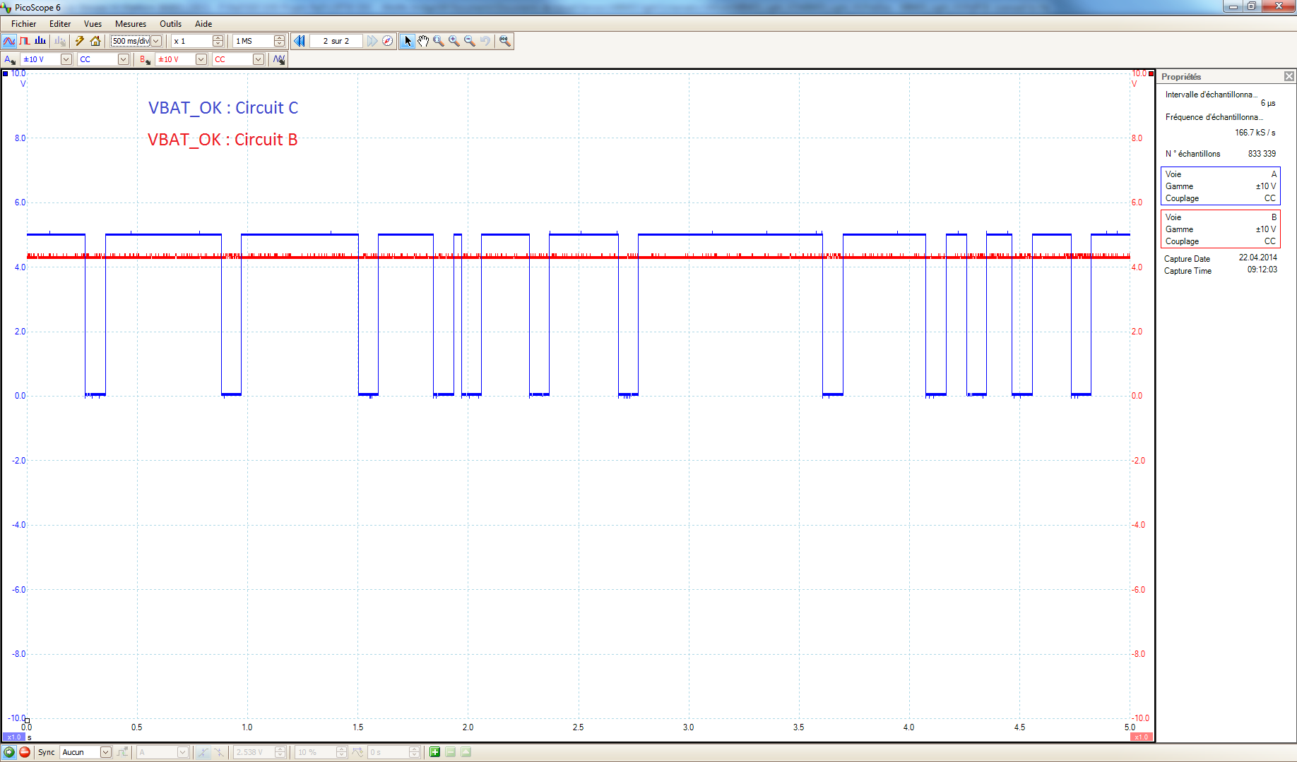

    The problem occur only when VSTOR is greater than ~4.5V and if the system is charging, below this voltage it is hard to do toggle VBAT_OK. I'm not sure it's a parasitic resistors problem.
    I do a test with 3 different (A/B/C) circuit at the same time under different temperature (-5° ; 25° ; 50° ; 80°) and each lighted.
    Circuit A : R27 = 4M7 (VBAT_OV @ 5V)
    Circuit B : R27 = 5M9 (VBAT_OV @ 4.3V)
    Circuit C : See above.
    Circuit A & C VBAT_OK toggling.
    Circuit B VBAT_OK work well.
    I tested another circuit (D) with a capacitor of 1.5F Rs < 0.1Ohm, and I noticed that VBAT_OK is more stable @ VSTOR 5.0V than circuits with a capacitor of 220mF Rs = 25Ohm. I added manually a resistor of 100Ohm to simulate a Rs of 100Ohm for the 1.5F capacitor, after the modification, VBAT_OK start to toggling frequently.
