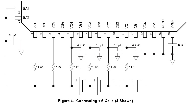

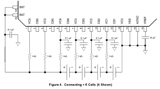

The datasheet of the bq76pl536a states that
"Unused VCx inputs should be connected to the next VCx input down until an input connected to a cell is reached – i.e., in a four cell stack, VC6 connects to VC5, which connects to VC4."
Because of some other requirements I would like to connect these 4 cells starting from VC6, could someone help me identify the technical issues related to it and the required changes in the schematic.
