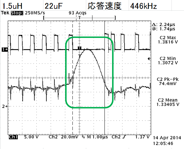

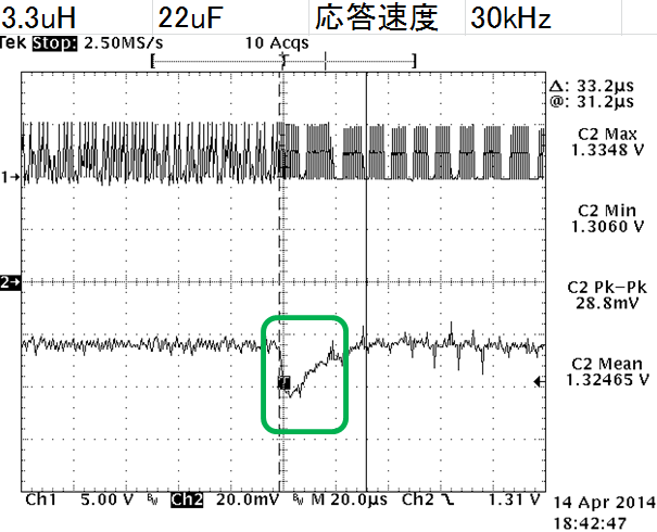

I have a question about Vout deviation of TPS62130.
[Condition]
Vin = 5V
Vout = 1.35V
Iout = 0.08A ~ 2.56A
L = 3.3uH
C = 22uF
Following picture is load transient response from min load(0.08A) to max (2.56A).
(Ch1:SW, Ch2:Vout)
It shows the Vout deviation is 28.8mVp-p, and it is no problem.
On the other hand, following picture is load transient response from max load(2.56A) to min (0.08A).
The Vout deviation is too large (104mVp-p)
Following picture is load transient response from max load(2.56A) to min (0.08A) with 1.5uH, 22uF.
The Vout deviation is too large (74.4mVp-p)
Q1: Please advise me how to reduce Vout deviation. (where max load to min load)
Q2: Please let me know about frequency response characteristic for the ripple injection.
