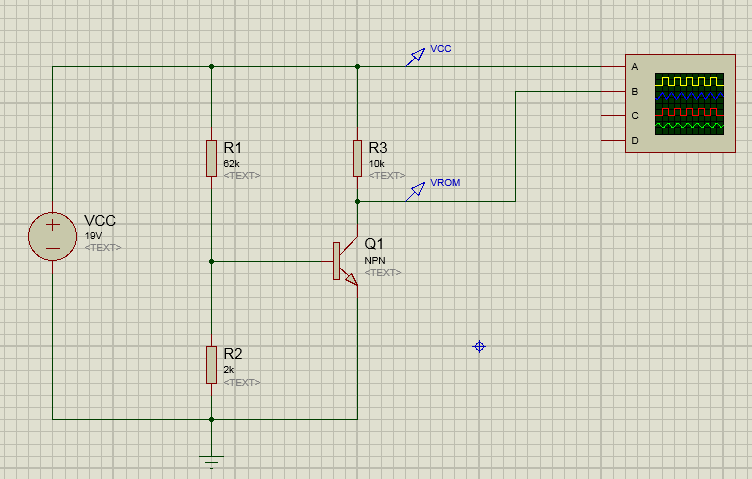

One of our project, we plan to use TLC5970. We are building video display unit and total pixel will be 50K.
After reading datasheet, we are really surprised about EEPROM programming procedure. In this case, manufacturing of huge number of products will be hard to handle.

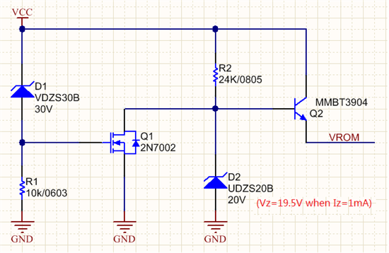

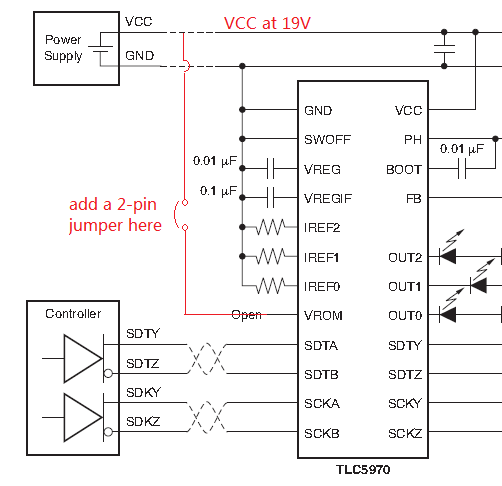

For EEPROM power supply - VROM - must be applied to all units to program EEPROM. Then, it should be released from PCB.
As you know, soldering VROM pin for programming and desoldering would be time-consuming for 50K module production.
OR, is there any way to configure TLC5970 accordingly when it is shipped?
What is the best and offered way of programming EEPROM? Need your guidance for manufacturing huge amount of production. For correct operation, every TLC5970's EEPROM 1 and EEPROM 2 should be programmed, as I knew.
