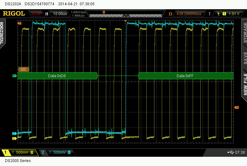

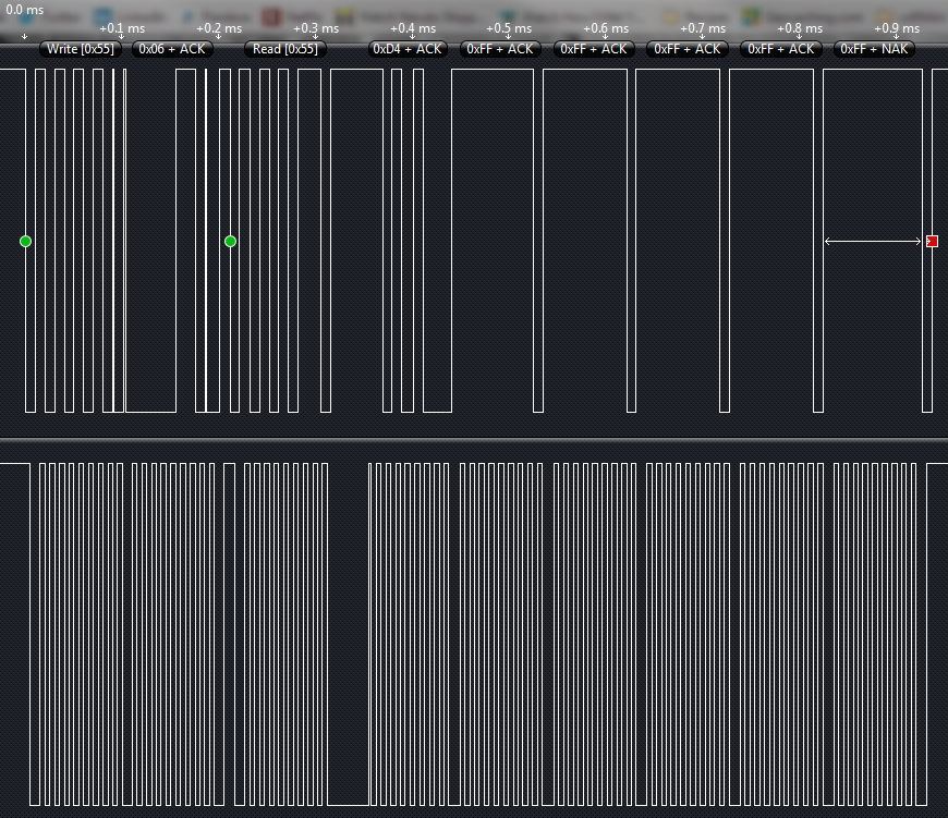

It is a little confusing looking at this because it is listed in reverse, but it is printed in the format of the memory map in the datasheet. These values are read in order from the bottom (B11010111) to the top. The first byte read is correct, but the rest are obviously not. My interpretation is that the bq27200 seems to be stopping the transmission after the first byte is sent. Perhaps it is interpreting a STOP instead of an ACK? Below is a capture of this moment in the communications (the end of the first byte read).  Both libraries resulted in the exact same waveform. Any help would be appreciated.
Thanks, Aaron
  • Here is the output from our Saleae logic analyzer. The protocol appears to be correct. Is my request for 6 bytes inadequate? Did I miss some communication caveat in the datasheet?

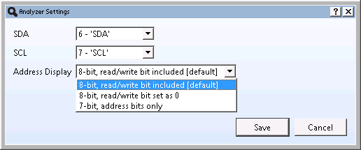

    So far I don't see anything that stands out to me, but one thing I see in Saleae Logic is the address field; I'm not sure if it's using the 7-bit address notation or the default 8-bit address + read/write. What analyzer settings are you using for it? Also, could you attach a copy of the .logicdata files from one of your logic analyzer sessions (Options menu -> Save Session -> Settings & Data)

  • I am only displaying the 7-bit addresses. It is sending [Add 0:6][1 or 0] as the address byte.

  • I just tried reading single bytes with both the Wire library and this I2C library. I was able to read memory address 0x06, but anything els. Wire.available() would return false and there was no data. I'm really stumped. A couple days ago I had the 6-byte read program on an Arduino in the setup() (so, it ran on reboot and did not loo) and I accidentally left it plugged in over night. Through the night the program ran about 15 times (random reboots? o_0) and 3 of those times it actually read correctly. I found the output in my serial monitor the next morning. I have not been able to reproduce it.
  • so even if you read 0x06, then 0x07 etc you do not get valid data?
  • Correct. I can read 0x06 and 0x07 incrementally and 0x06 will return correctly and 0x07 will always return as 0xFF.
    Even if I read just 0x06 and then perform another read at 0x07, 0x07 is wrong. :-/

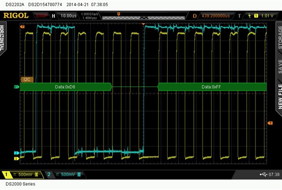

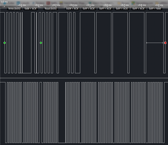

  • I just realized that I sampled my last logic analysis at only 1 Mhz. 1 microsecond resolution isn't very helpful. Here is a new set of files. This contains a csv and binary of a 24 Mhz analysis.
