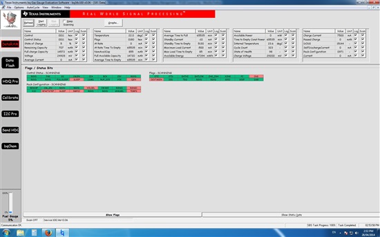

bq34z100 difficulty in achieving a learning cycle
Other Parts Discussed in Thread: BQ34Z100, BQEVSW
I am attempting to perform a learning cycle on a 1p8s 15Ah LiFePO4 pack of headway cells but am not able to get the FC bit to set and thus progress to 0x05 in the IT flags.

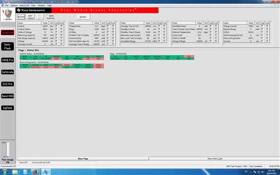

Attached are screenshots of the RAM after clearing the IT flag, sending a reset command (0x41) and then resting,
as well as, immediately after enabling IT (command 0x21).
Also attached is the gg file of the flash before and after enabling IT.

Can you please have a look to see if there is any parameters which I have not set correctly. I have not been able to find any solutions on the forums which seem to work for me.
Some things to note about the system: I am using the EVM but have changed the sense resistor to 2 mohm to facilitate a higher current operation. The charger I am using charges at about 6.8A and cuts off when the current draw falls below approximately 450mA.
I am currently logging data during a charging cycle and can post it when it is done if it is helpful.
Edit: also attached is the log file of the charge
