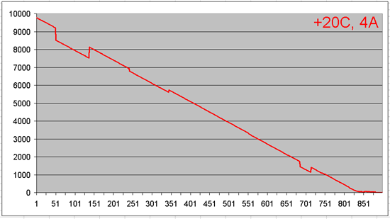

Hello.

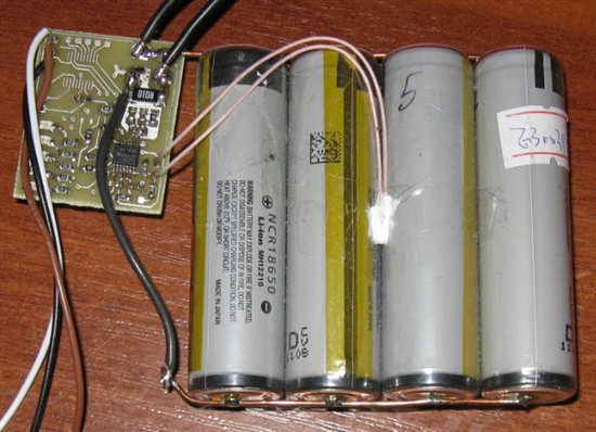

I trying use bq34z100 with 4-parallel NCR18650 Panasonic (2900ma) battery set, but after testing got very bad results. Please check my records, maybe you can give me recommendation for improving working with this ICs.
At first I set config for my battery specification and received golden image (file "config.gg"). Here three graphs of Remaining Capacity prediction in calibration progress when discharging (graph1).

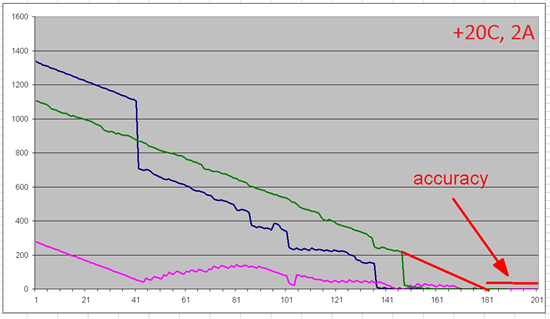

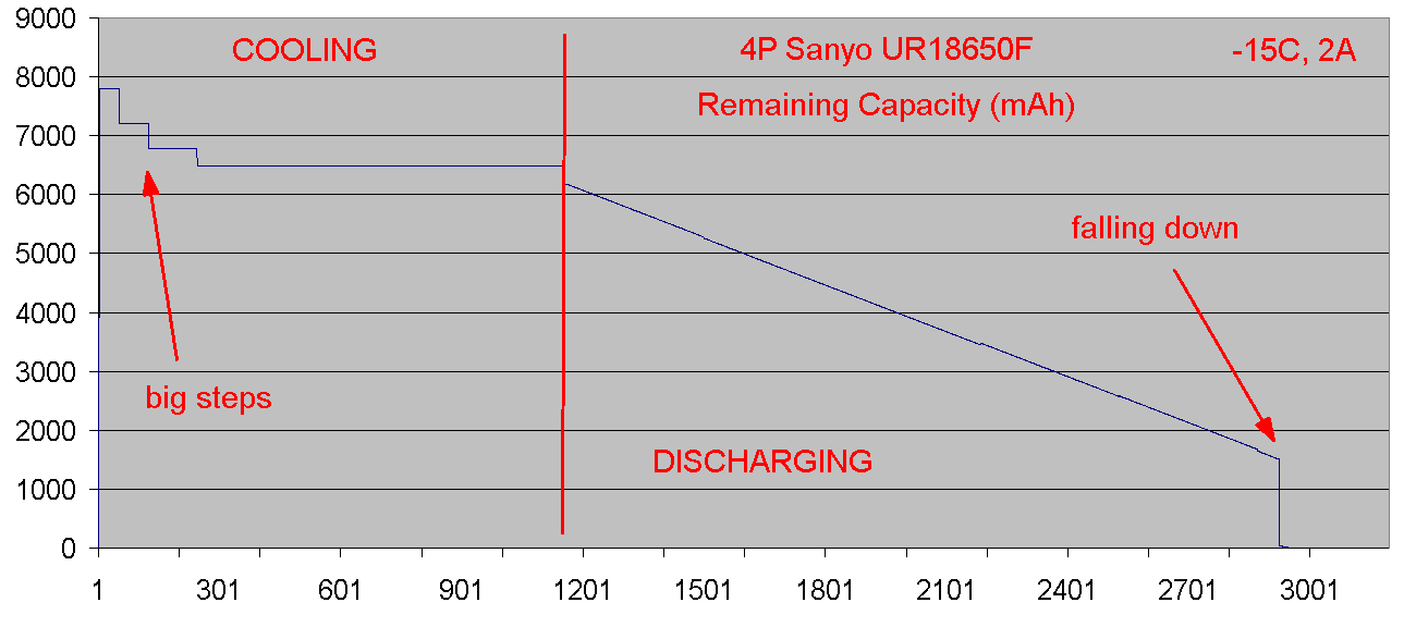

As you can see, the last (3) curve has a very good precision, if draw a line for the end (graph2 is zooming) we get about 1.1% accuracy in overall. But shape of the graph is not very good for real use, because it have unknown step-fluctuation (with sharp jumping of % capacity about 2%, see graph1). Besides, prediction capacity is over before voltage reached minimal value. Please see graph3 with end of third calibration curve with imposed voltage curve. As I understand, prediction capacity must be related with current voltage according chemical table (for my type of battery NCR18650, wich be uploaded before calibration), but correction too juddering, even it is.

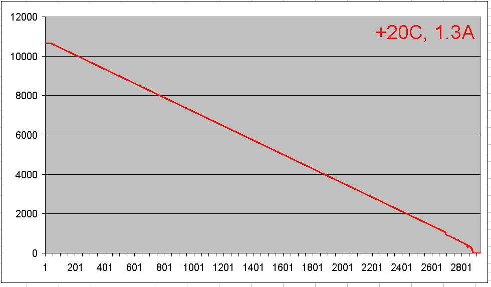

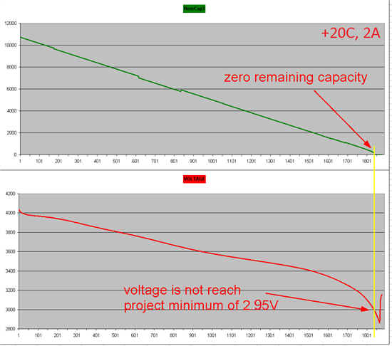

Here measurements on a less current ~1.3A, results not bad (see graph4), exept step-down at the end.

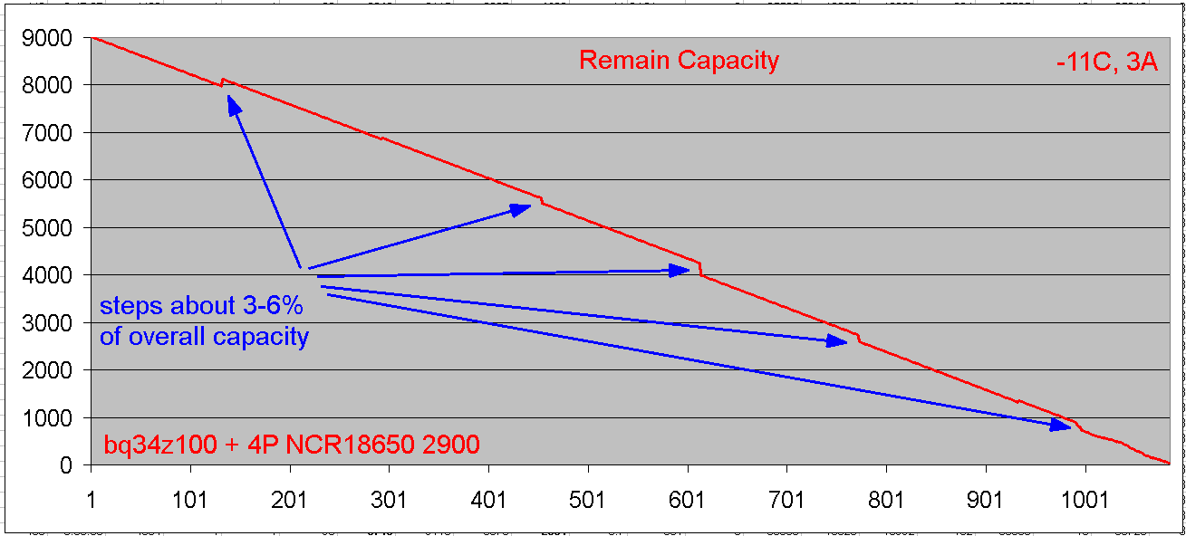

Here measurements on a larger current ~4A (see graph5), and results not very good - curve of remaining capacity prediction fall down on about 9% earlier of real capacity. And again we see a several big step-fluctuation (as I understand this is may be a fault of comparing with chemical table).

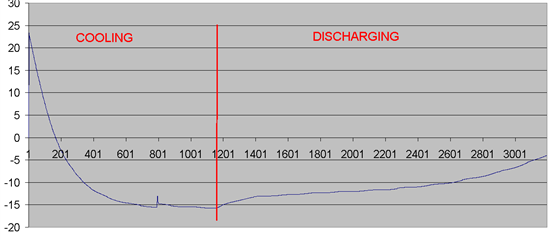

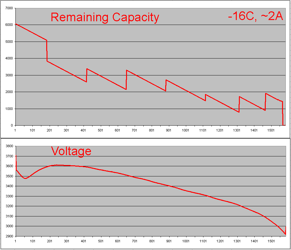

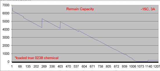

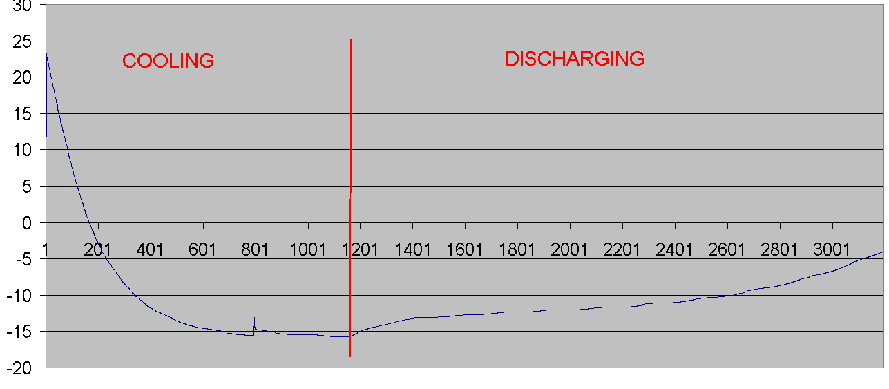

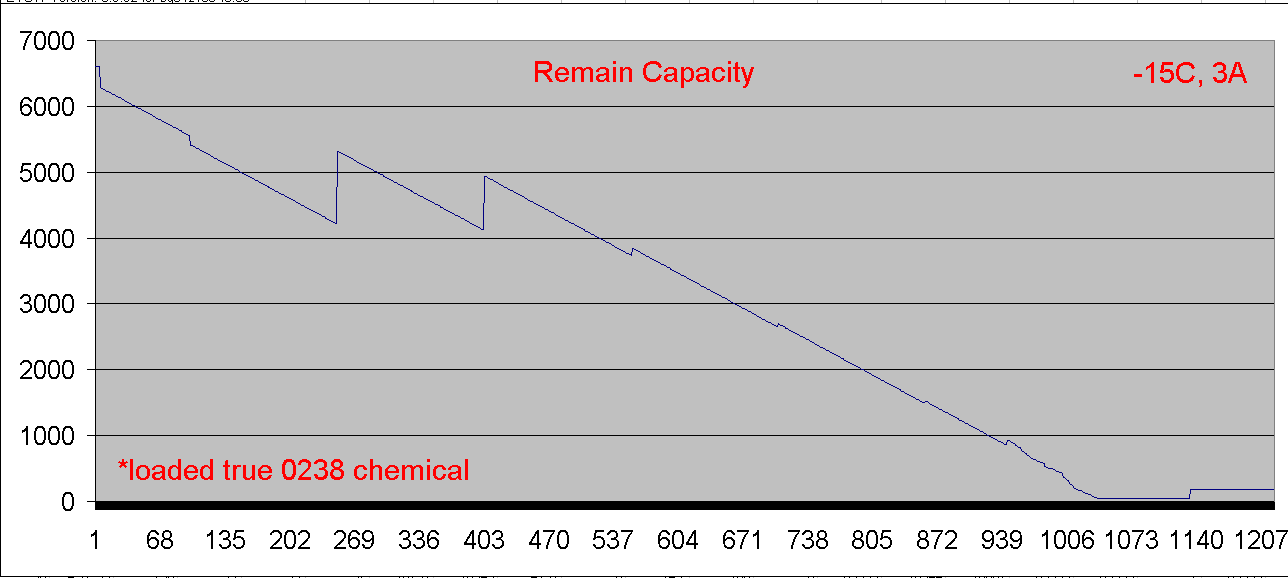

And next battery prediction testing at different from calibrated temperature on about -16C. Results very poor. (see graph 6) Curve has giant steps without any correlation with real capacity.

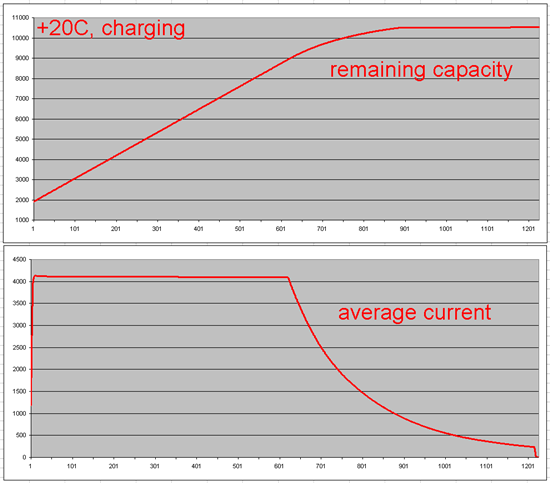

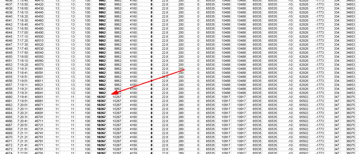

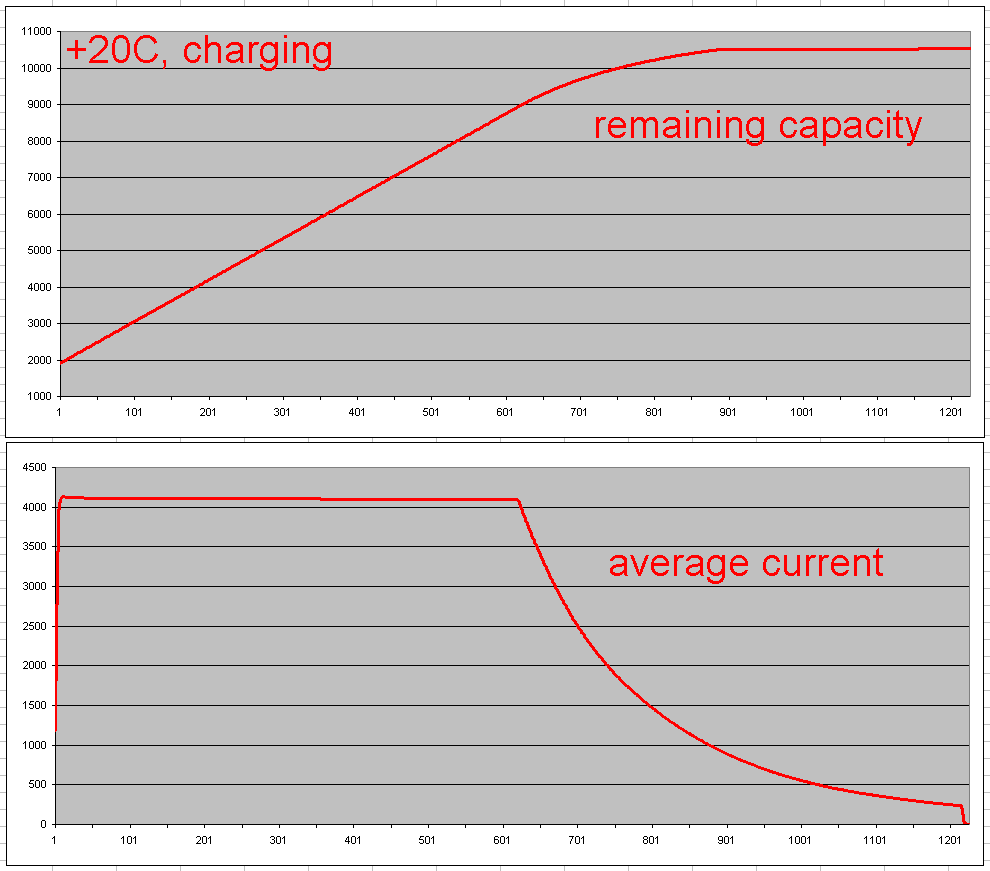

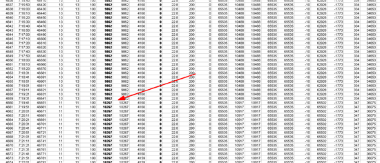

However, once I noticed, that counting on charging is not work correctly at the end of charge. Capacity counting just stops on certain value and not count some % of energy. Its happend while charging battery after it was fully discharged at -16C temperature, then heated by the room temperature with restoring remaining capacity to about 2000ma. See graph7.
So, as I see capacity prediction is not work correctly, but cant find reason for this.
Q1. Whether it is possible smoothing graph of remaining capacity prediction to eliminate step-correction of prediction?
Q2. Is it possible eliminate graph break at the end and strech it according minimal voltage value?
Q3. How to reach good working bq34z100 with my battery on terms different from first calibration (20C, 2A)?
Q4. Why there was a failure of capacity counting on charging?

  • Viktor,
    I have been out of the office on vacation, so I am sorry about the delay. I have not had a chance to review all og the log files yet, but I reviewed the gg file. It shows that ChemID 107 is loaded. Are you sure that you loaded ChemID 0238 when you ran the tests.
    Tom

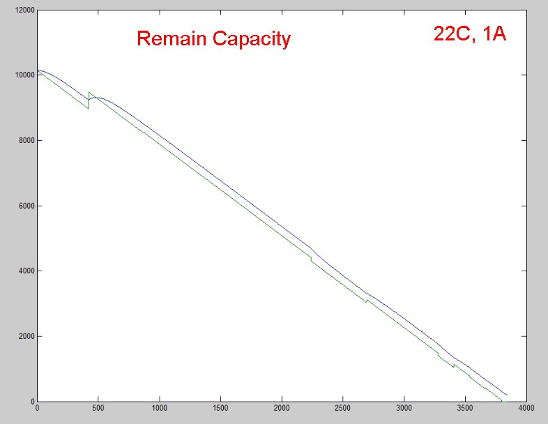

  • Hello Tom
    Thanks for your answer. You right, this testing has been not correct, because of wrong chemical selection. But its not my first testing and at previous I received bad results too. This is my 4P x Sanyo UR18650FJ setup results (which chemical selection mistakenly still in new design). At first on slowly cooling battery in thermostat Remain Capacity prediction has very innacurate change. At second - unexpected falling down at the end. But I use not fresh battery cells for this test, maybe it is reason of this...
    Now I'm trying recheck my 4x2900 Panasonic setup, which must be in final design. I tried keep calibration and just reload correct 0238 chemical, but got bad results again, maybe because of wrong previous calibration.

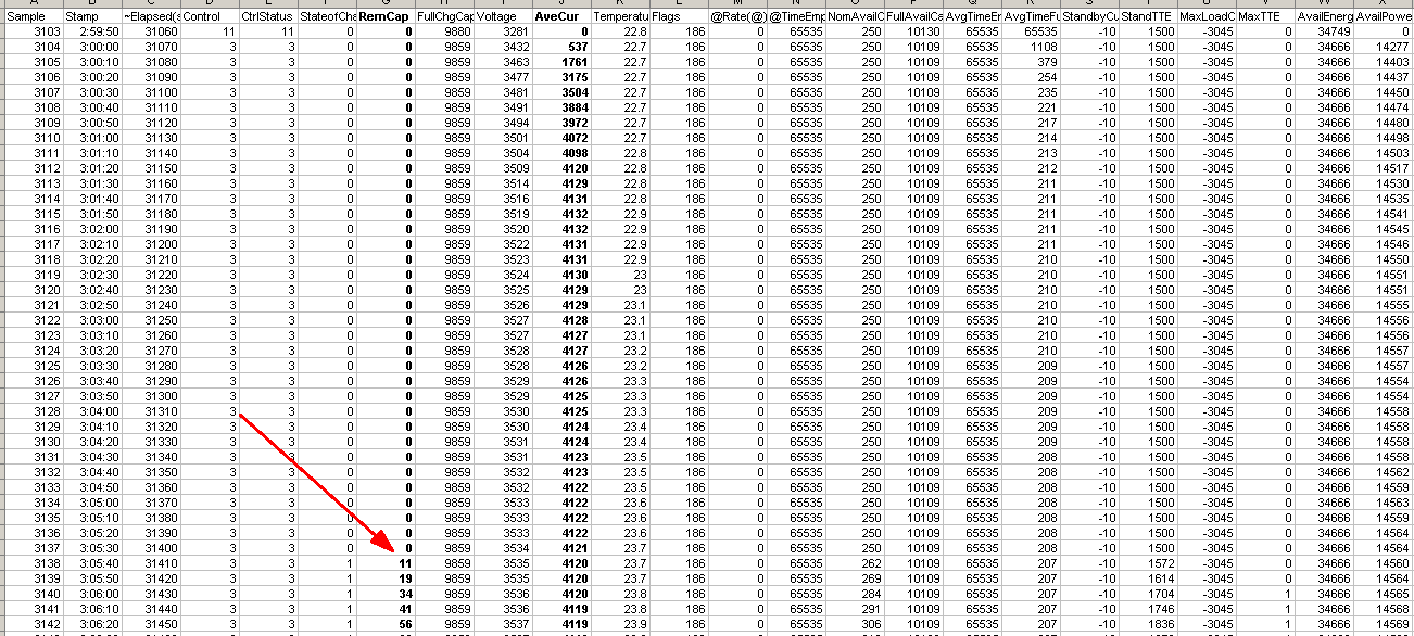

    So I send command reset (0x0041) and begin new calibration with correct chemical id. At near time I will write new results of my testing.
    However, I notice some strange in current log file during recalibration - Remain Capacity is not calculated on start charging (about first 6 minutes) and stop change values when FC bit set... but after 35 minutes its changed to real value. I attach a piece of log with one charging cycle with this strangeness and new config file.

  • I completed calibration and done prediction testing. Results much better that first time I posted, but tendency of step-correction still remain. However, when I used bq27510 I obtained curves, which was not ideal flat, but deviation was very smoothly in time.
    So, can curve of Remain Capacity be smoothed in bq34z100 to obtain prediction without steep drops/rises in time?
  • Viktor,
    The bq34z100 does not have a smoothing filter, so you may see steps in RM and FCC as the device runs simulations during discharge.
    Tom
  • Tom,
    I tried to apply filtering to data I'v got, but results are still unacceptable. If I install this on real device users can be confused by SOC increase when battery is actually discharged.
    So, can bq34z100 give discharge prediction curve that after smoothing be overall continuously decreased on constant current load in various value (about 1/50C to 1/3C) and temperature range (-20...+40C)? Maybe, you can give an advice for filtering algorithm to be used with date returned by my IC?
    If not, please help me to select IC that returns nice, smooth and accurate capacity predictions.
    Viktor
  • Viktor,
    You do not need to use a multi-cell device since you have a 1S4P configuration. Can you use the bq27510 that you found to provide acceptable performance?
    Tom
  • Tom,
    Our assembly house can't handle SON package reliably. So I want to use part with TSSOP or silimar (not too fine pitch) package to get high production yeld.
    Viktor
  • Viktor,
    Unfortunately, our high performance single cell devices a only offered in SON packages. We have some older CEDV type gauging solutions that can support single cell and they are offered in leaded packages. They are the be20xx devices.
    Tom
  • Tom,
    I know about bq20X ICs, but I search only with Impendance Track technology.. as I think its can get much better prediction. How about bq27350, does it provide good prediction, like bq27510? I am a little confused by the revision date by 2009 year.
    Viktor
  • Viktor,
    I do not work with the single cell gauges, so one of the other apps engineers will let you know which will be the best choice.
    Tom
  • Ok, thanks. Hope for soon response...
