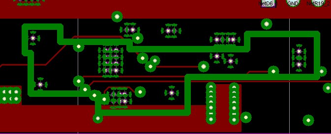

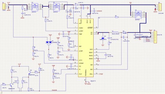

Hi TI,I design circuit to charge 3-cell Li-ion batterys refer to BQ24170 typical application,when  test there are some problems as following:
1.When insert 13.5  adaptor,output voltage with no system load is right,13.5V.But when the load is connected ,the output voltage reduce to 1.2V.
2.The Vref is not 3.3V,3.6V.
3.Connect the battery to the board,the output volatge is right;
4.The led blink all the time.
