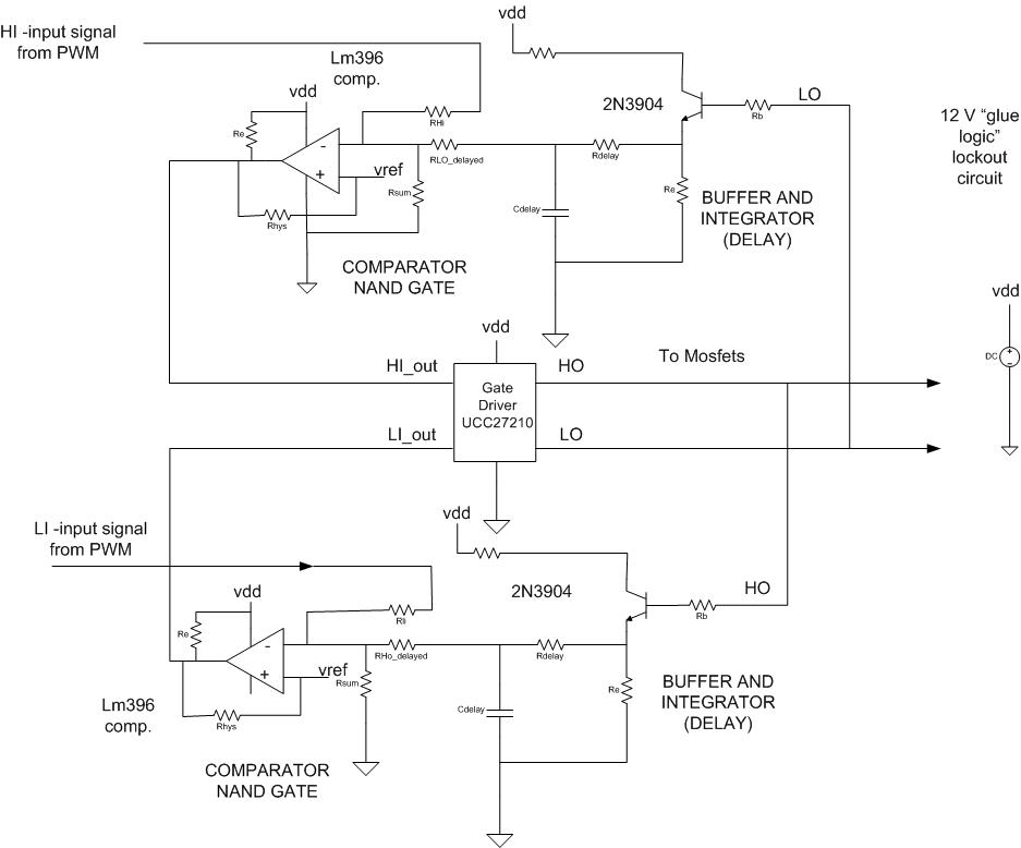

If we keep both input (HI and LI) HIGH state, will both output(HO and LO) become HIGH?
Does UCC27210( or other Gate driver) have some function which prevent the condition that
both output become high simultaneously like LINEAR TECH LT1336?
http://cds.linear.com/docs/en/datasheet/1336fa.pdf
(As for the LT1336, If we keep both input  HIGH state, both output  become LOW state.)

    I am not a TI rep, and I have not used this part before, so I can't say for sure. But judging from the block diagram in the data sheet and looking over the pin functions, I'd say there is no gate lock out feature in the UCC27210. However, you do have to pay for the extra feature: the UCC27210 cost 3.89 ea. and the LT1336 costs 6.00. And the 27210 has some nice features the LT1336 doesn't have, like 120 V boot voltage and high voltage spike immunity at the pin inputs. If want to use the UCC27210 and still have the lockout feature of the 1336 you can add some "glue logic". I have worked out a design idea you may use. (See picture below.) I didn't calculate any of the component values or test the circuit -I am just presenting it as a suggestion. I have used similar circuits before. I have to use comparators because the logic gates work on 5 volt logic. The high logic threshold for the UCC27210 is 5.8V maximum. These extra parts do take up some board space, but they cost less than a 1.00, so your are still less expensive than the LT1336 and you have the high voltage features of the UCC27210.
    The circuit is very simple. The HO signal is buffered and delayed to prevent glitches and race conditions. then it is summed with the LI signal. If they are both "high", their sum will be more than Vref and the input to the UCC27210 goes low. Same for the high side.
    Hope this helps,
    Chuck Sampson

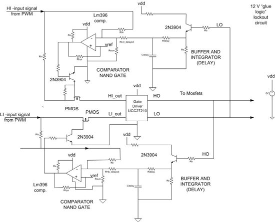

  • Hello Kening,
    My circuit suggestion is incomplete. I have added a more detailed one. I will test this circuit sometime this week and get back with the results.
