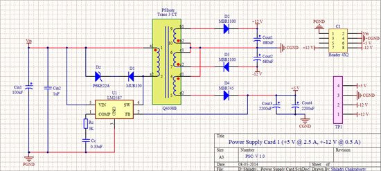

I am using the LM2587 to obtain a +12V,-12V and 5V supply.
The circuit is the same as Fig. 29 of the datasheet.
However, I am facing the following problem :
As I slowly increase Vin, initially nothing happens. However, after Vin reaches 5V, the input current
suddenly increases (about 2-2.5A) and hits the current limit of the input supply.
Any ideas what may be the problem?
I have double-checked the circuit so I am pretty sure there are no errors in the PCB as such or with
components.
Initially, I am operating without connecting any external load-resistor. Do I need to operate with a load
resistor connected always?

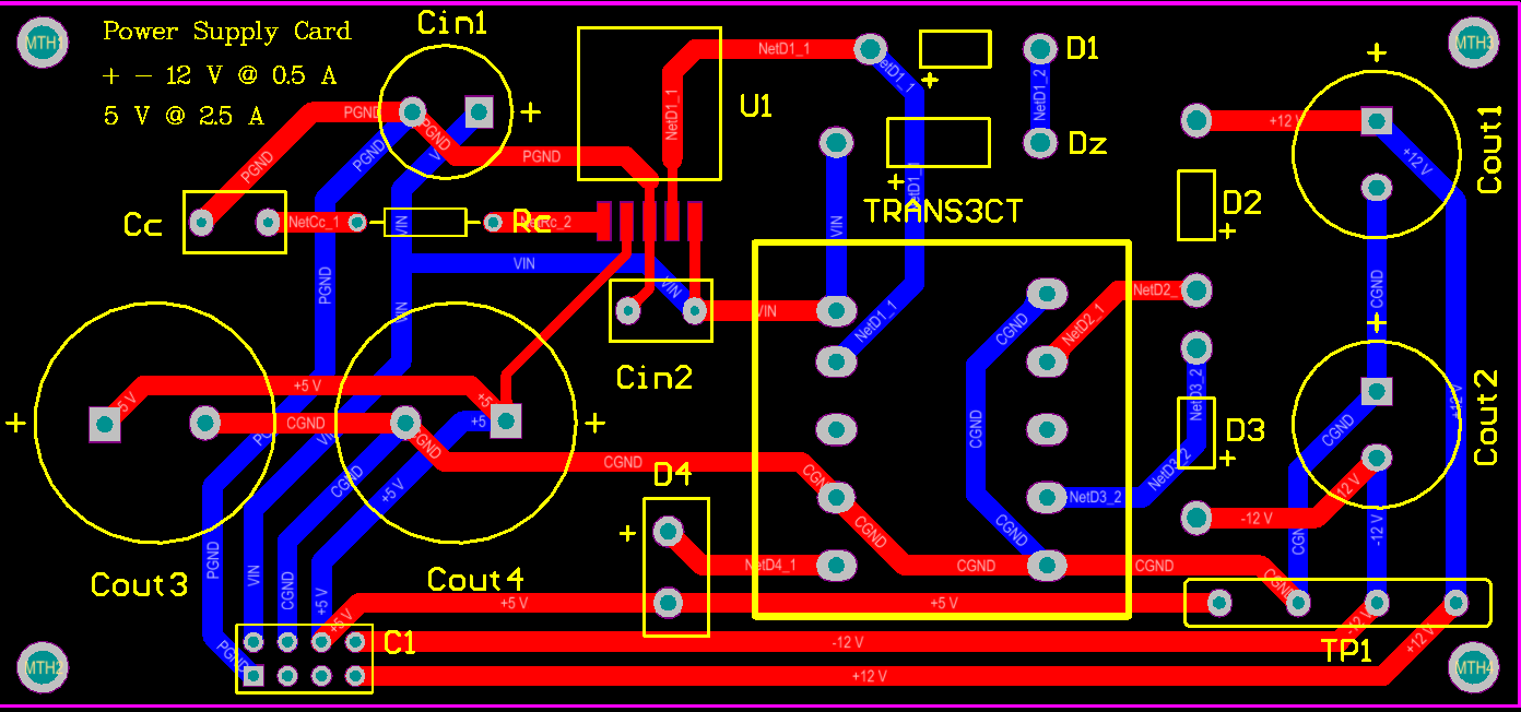

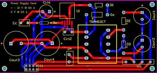

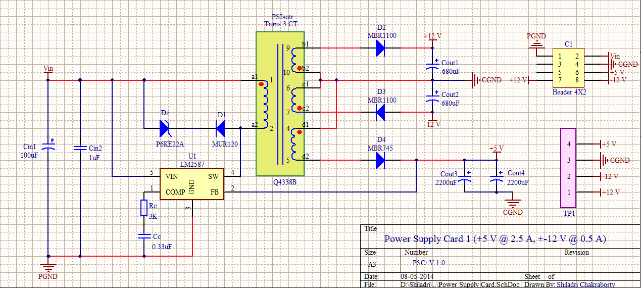

  • Dear Juan,
    Thanks for your reply. I tried the things you mentioned.
    -First I removed all the secondary diodes but still the problem remained. Clearly this
    meant the problem is on the primary side.
    -Then I removed the transformer altogether from the board (virtually opening the primary)
    and then the current limit was not being hit
    -Next I connected a simple inductor between the terminals where the earlier transformer primary was
    and again on giving supply the problem reappeared.
    Where do you think things are going wrong?
    The schematic and PCB layout are inserted for your reference.
    Shiladri
  • Hi Shiladri,
    So if the problem is clearly on the primary side, please check for short-to-ground connections with your board powered off.  It sounds as if you have a passive component that's damaged and pulling the supply down or there's damage to the IC already.  So ohm-out the IC pins for any short to grounds and see if that's the problem.  If so replace the IC and step by step populate the components of the secondary.
