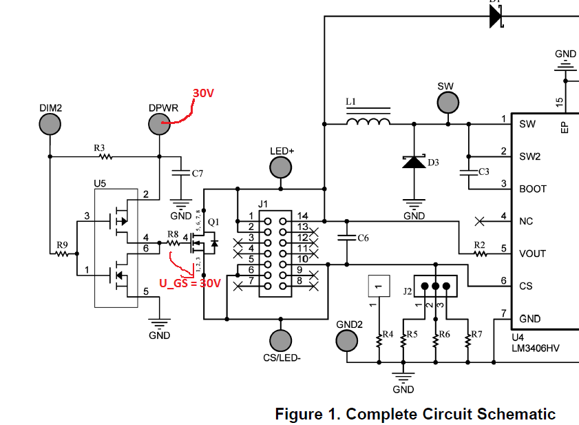

2:
In the user guide  AN-1993 LM3406HV Evaluation Board with 2 Wire
Dimming on page 4 http://www.ti.com/lit/ug/snva407b/snva407b.pdf stands:
"A voltage of up to 30V must be applied to the DPWR pin to operate U5"
But, is 30V not  to high for the mosfet Si4464DY (http://www.vishay.com/docs/72051/72051.pdf) ?
This have a U_GS from +-20V ?
Could you explain it, please?

  • Hi Victor
    thank you for the reply.
    2:
    I think, we have misunderstood us (Sorry, my englisch is not very well).
    Ok, I understand in my case U_DS=36V.
    In the user guide http://www.ti.com/lit/ug/snva407b/snva407b.pdf on page 4, the third sentence:
    "A voltage of up to 30V must be applied to the DPWR pin to operate U5."
    I think, if DPWR=30V, then is at the mosfet Q1 U_GS=30V. In the datasheet, of the mosfet Q1 SI4464DY-E3 is the maximal U_GS=+-20V.
    Q1 becomes damaged?
    Where is my mistake?
    I sketched the voltage in the schematic.
    5:
    Ok, I understand,that I must protect the zdiode.
    Can I connect the zdiode like in the schematic, too ?
    Dirk
  • Hi Dirk,
    2. You are correct. If you use SI4464DY-E3 as the reference design did, then the maximum voltage of DPWR will be 20V.
    5. Yes, I think you can do OVP that way. Please be aware that since your LED voltage is 36V, you may need to change the 1kOhm resistor value.
    Victor
