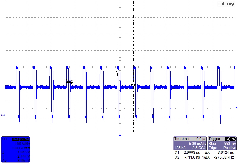

    In addition to above, we would like to know the PFM frequency in case of Vin=3V, Vout=1.8V and Iout=20mA.
    Unfortunately, it seems that the simulation on PFM mode is not supported on neither SwitcherPro nor Webench for this device.
    We thank you once again for your information.
  • Since you have the EVM, this could be measured under any condition you want.  But here is what I see:
    Would you be able to share more details about the end application?  You have asked about shutdown current, efficiency, output accuracy, and PFM frequency.  The TPS62740 sounds like a better fit from your questions in all things but accuracy.
