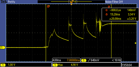

The 3.3V power supply goes out of regulation after multiple turn on and off. If the supply is on and regulated correctly it works without any issue. But when on turn on it fails to regulate then, the supply has huge oscillations.

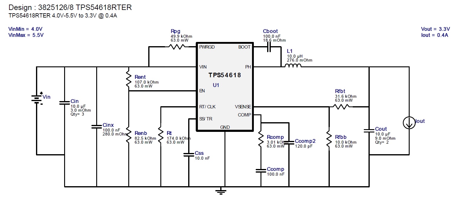

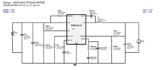

I am not able to debug where the problem is. Following is the schematics of the power supply.
In actual design the Enable pin is connected to Power Good signal from 1.2V power supply and has pull up to 5V.
Also I have changed the inductor value from 10uH to  3.3uH.

  • Can you post some waveforms in both the good and bad operating states?  Make sure to include the PH node.
  • Hi John,
    Following are the waveform for the 3.3V power supply. I can see that the waveform of Cboot point to Ground is having higher duty cycle compared to other voltage regulation ICs.
    3.3V startup waveform:

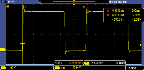

    3.3V Cboot waveform:

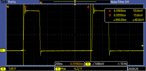

    Other voltage regulators like 1V, 1.2V and 1.8V have following Cboot waveform

  • the duty cycle of the BOOT voltage will be approx. Vout/Vin so it will be different normally.  The firsrt waveform you posted is Vout = 3.3 V?  I have never seen one like that.  Can you include PH and SS as well?  Also a shot with Vout, COMP and PH?  I'll need to see the same time scale as above as well as a zoomed in plot.  Trigger on one of the falling edges of Vout.  Can you post your actual schematic and PCB layout?
