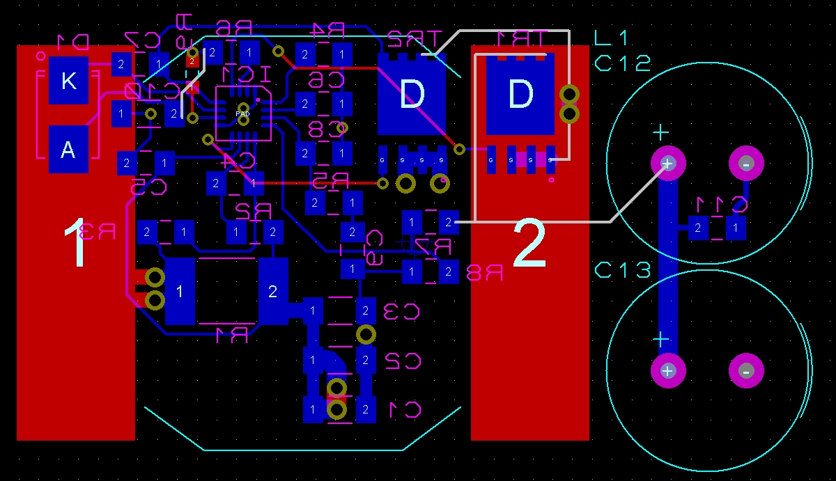

We are using the 43060 in a 12V to 50V 0.8A boost circuit.  Switching frequency is about 300kHz which we are using with Infineon BSC340N8 low gate charge FETs.  The chip gets very warm and eventually fails in the corner of the package close to the VCC supply.  It seems that the VCC supply is overloaded and doesn't appear to have any form of protection.
We have added the 2R resistor recommended (on the last line of the data sheet almost as an afterthought) although there's no information about how the value should be selected.  The resistor is also shown between the chip and the output cap: is that right?
Should we be increasing the value of the resistor to limit current into the boost diode?  If so, by how much?

    I'd also like to check a few more details on your board. Could you share the full part number of the MOSFETs?Was this on a EVM or a custom board? If it's a custom board can you share the schematic and layout?

    Full MOSFET pn is BSC340N08NS3.  They were recommended by Webbench.  It's a custom board, the circuit is attached as is the layout.  There's a problem with the layout in that it was designed with the rectifier FET (TR1) the wrong way round so some cutting and re-wiring was necessary, shown in grey.   The 2R resistor has also been added. There is a single ground plane beneath all the components, not shown for clarity

  • Thanks Rob. The schematic looks good. I can't see the layout very clearly though. Could you post a bigger image?

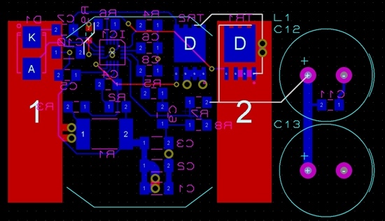

  • Yeah, bmp format isn't great but our CAD system can't export in many formats.  Try this one, generated from a screenshot.  Once again the grey lines are links added to correct errors.

    Thanks for the new image.
    I'm not so confident in this layout and it could definitely be a source of your troubles. I've listed a few specific things I noticed below.
    Some of the signals in the power path have quite small connections. I cannot see where the drain of the low-side FET is connected to the source of the  high-side FET. Is it just this grey wire connection? Same comment on the output voltage connection of the output capacitors to the high-side FET drain.
    R8 and C9 return to GND goes to the input capacitors which is more of  PGND area. These should return to AGND first. Also the placement of a lot of the 0603 R's and C's is not very ideal. Specifically pay attention to the GND pin they return to first.
    I'd recommend copying the TPS43060EVM-199 placement and routing of the small R's and C's as close as possible here. I think you could copy this placement without too much trouble on your board then place the power stage (input caps, inductor, sense resistors, FETs and output caps) where you need them to be for your board shape. It looks like you were able to get all of this on one side and put the inductor on the other.
    For the power stage it's important to minimize the length of connections and use wider traces as they carry higher currents and can cause noise. For the analog control circuitry its important to keep these away from the power stage components current paths and return them to the AGND pin.
