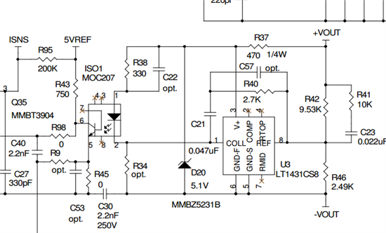

  • Ok, thank you for your support. Any help is appreciated. More information for anyone who can help.The feedback configuration in the designis as follows below
    The values for R40 and C57 have been changed for the application as this sets the feedback poles. The poles from the datasheet were calculated from the following formula.
    In the design Co=101.33uF, with a max load of 1K this give a minimum pole of 1.57Hz which didn't seem right to me. The zero pole has been calculated at 1254Hz and the maximum at 1576Hz with no load. Does this sound reasonable?

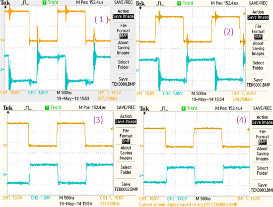

  • These are the high side switching waveforms of the MOSFET's with (1)=At 28V input with ZVS overlap (2)= 24V input (3)= Signal at cut off before the output reduces and (4) = At 20V with reduced amplitude.
  • Latest update, the power supply is regulated at the 350V output under 5k load, however when the 1k load is connected the voltage drops.
  • Problem solved under full load conditions the ZVS was reaching full duty cycle, with the minimum overlap achieved the voltage began to drop. Changing the transformer winding ratio allowed for the 350V to be achieved throughout the input voltages.
