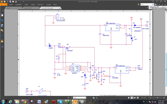

Hi
 we are using BQ 2057 for charging two cell lithium ion batteries each battery has (3.2V) for 7.4 V output
here i had attached the schematic of charger circuit ,

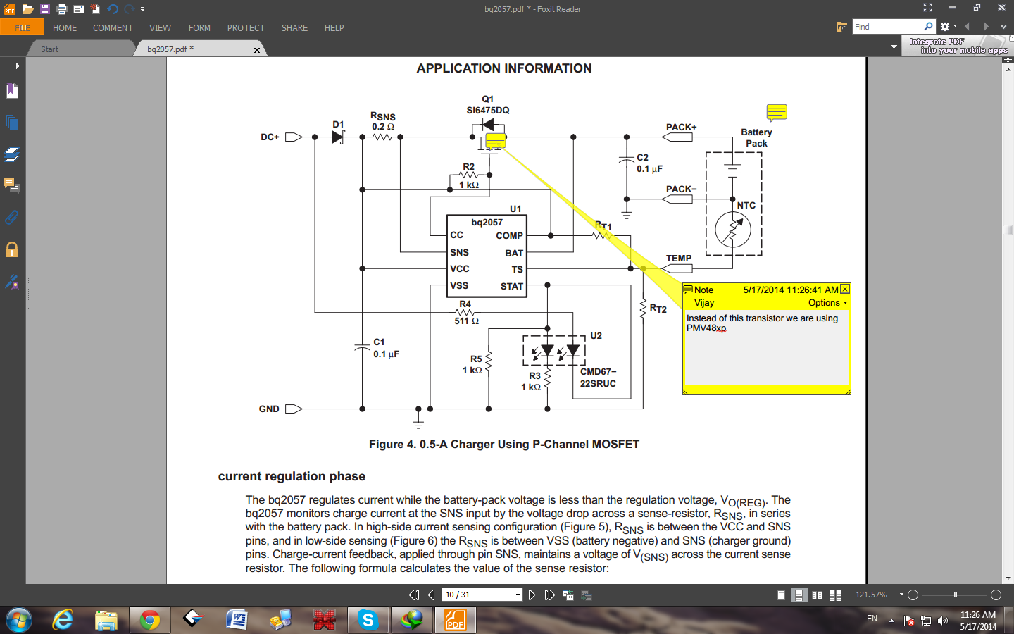

we are using 9v power supply for the circuit , after the circuit has powered up then i connected the battery then i found that the PMV 48Xp mosfet was heating up .
if prolonged for <30 sec it caueses the mosfet failure ie damage
why it was heating up.... and the battery also not charging
i measured it was giving 300 ma output after battery connected
Thank you
