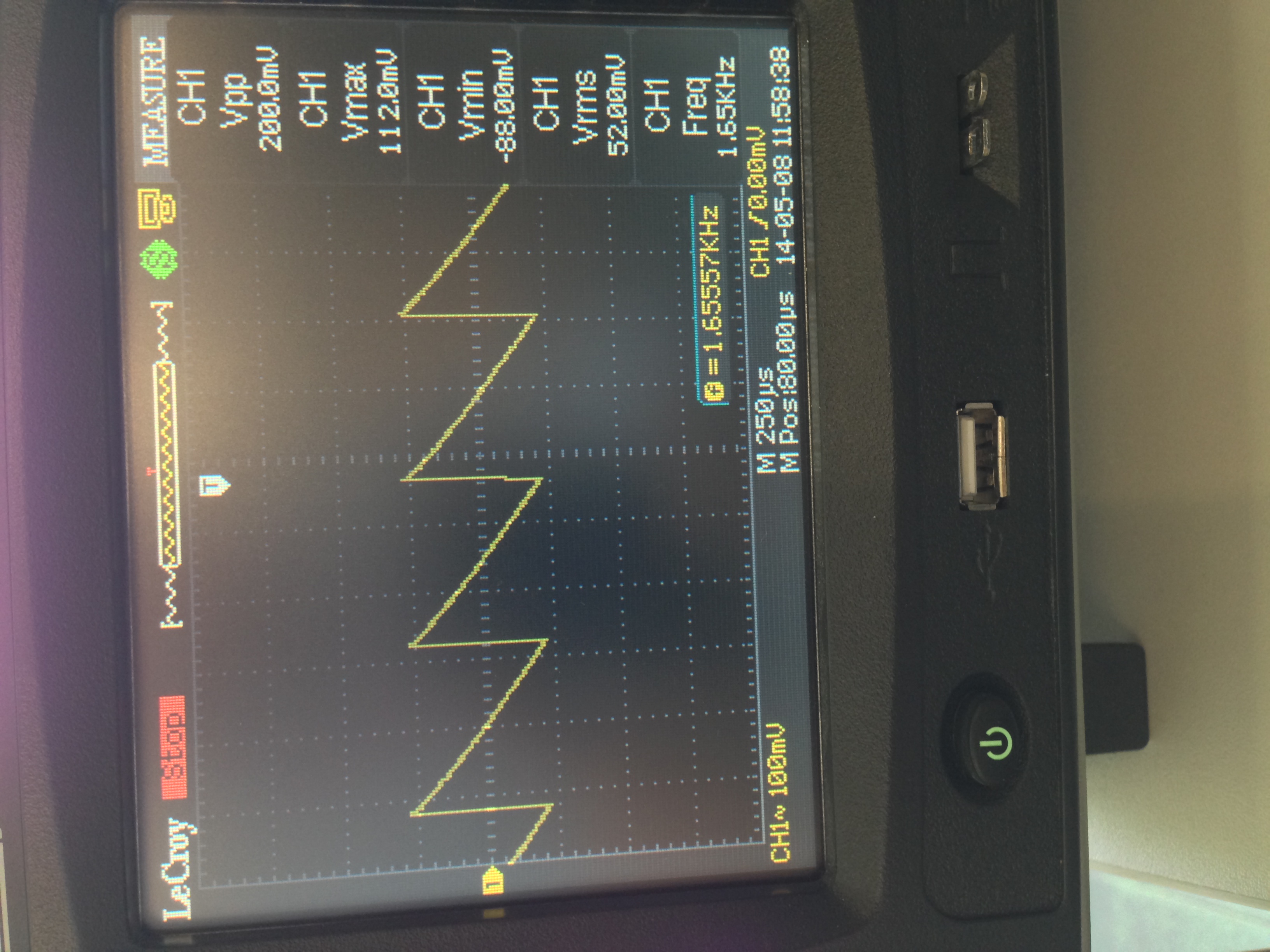

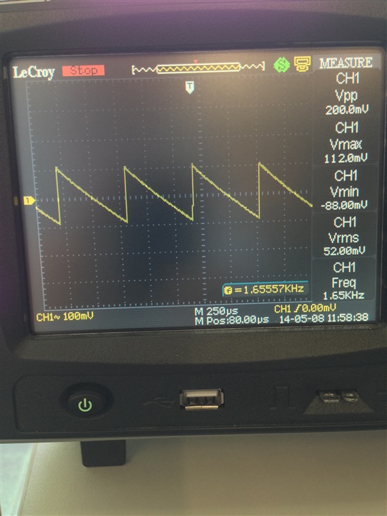

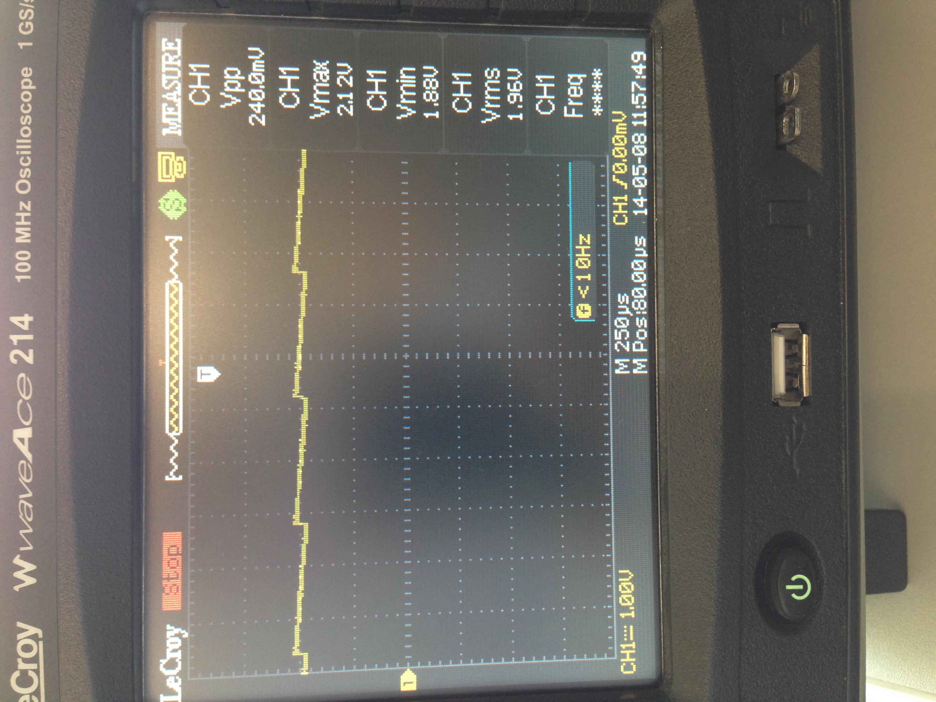

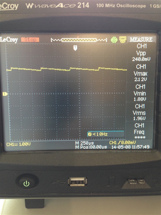

I'm having a huge issue with the TLV70030DBV part. The output of the device is around 2Vrms and with a huge ripple. We have assembled 10 parts and all the parts have the same behavior.

Here you can find the graphs of the output of the TLV70030DBV :

  • Hi Filipe,
    Could you please share a scope shot of the input to the LDO?  Is there anything else on the same rail that could be jerking the battery around?
    Also, what is your typical load current?  Is it possible that your load could be current limiting the deceive?  Could your load be causing transients?

  • Hello, Ryan.
    The battery is only connected to the LDO pins 1 and 3. The input voltage of the LDO is very flat. The current at the input is around 4mA.
    The load is only a microcontroller and a RF integrated circuit. I'm not seing where it can be any transients.

  • Hi Filipe,
    If you were to replace your load with an equivalent resistance, do you still generate the saw-tooth waveform?
