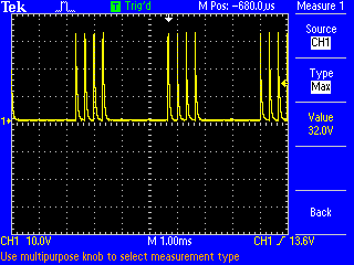

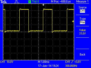

  • Hi Victor,
    I have now designed and built some prototype boards with the same circuit as the Eval board.
    however the output as well as several other parts of the circuit which i have scoped have a very different response.
    i have attached a scope trace of the output of my circuit and the eval board for comparison.
    do you have any suggestions as to what might be causing the problems?
    if you need any further info please ask.
    thanks
    Mike
    the output from the Eval board:
    The output from my circuit:
  • Hi Mike,
    Have you tried to swap the components on EVM and your board?
    Is there anything abnormal on the switching node?
    Victor
  • Hi Victor,
    It turns out I had ordered the incorrect value for Coff. 470NF instead of pico which caused steppiness due to having the wrong switching frequency.
