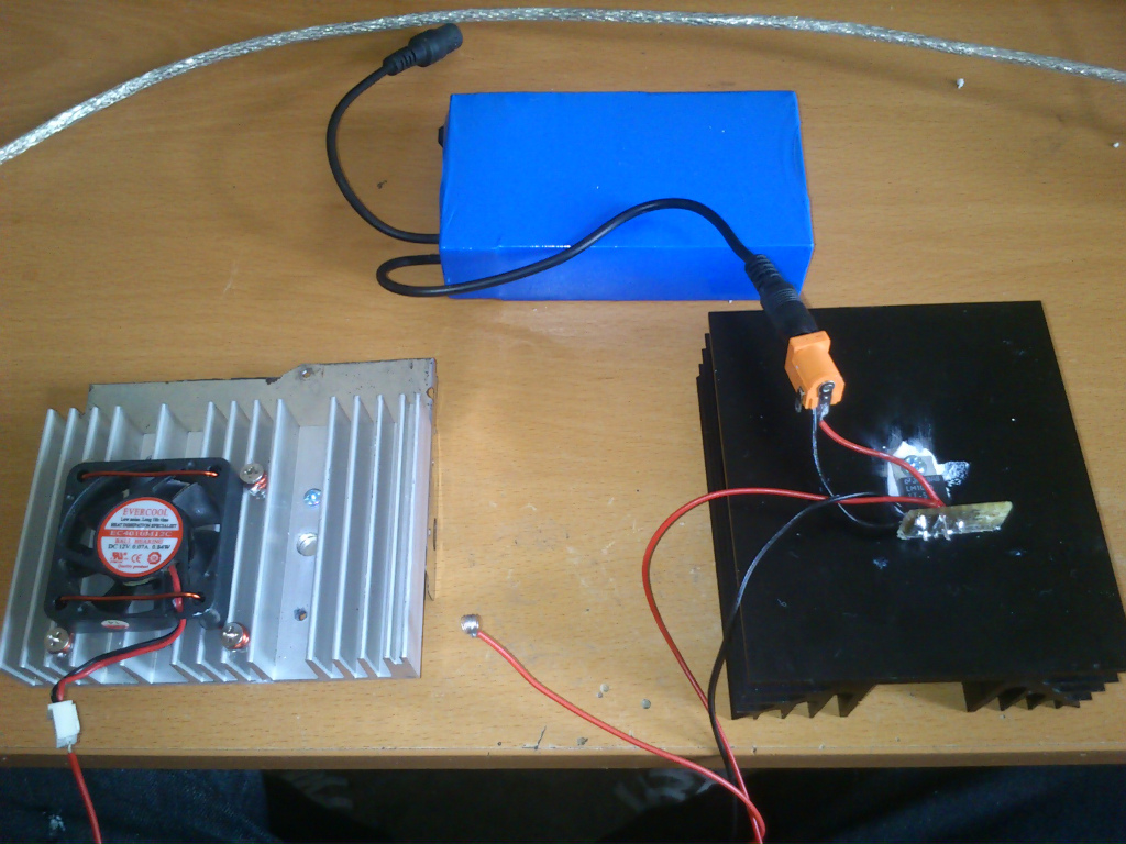

i have a 12v/9000mAh battery witch powers an ODROID board that consumes from 0.5A to 4A
i used an LM1084-IT 5.0 to convert the 12v to 5v, it works fine, but as the board consumes more and more, the LM1084 stops working
i checked with my multimeter, the load, it seems the IC stops working before reaching 2A, the board does not even start
without the multimeter, the board starts but as i benchmark prime numbers calculations (CPU is a quad core)
the lm1084 stops after like 30 seconds
i used heatsinks that go less than 2C°/W
i wondered if anyone could give me any advice
[edit: the circuits i use is the simplest possible, the + of the battery is linked to the Vin, gnd is linked to the - of the battery. and the Vout is linked to the ODROID board (as the GND of the lm1084]
    As a starting point, can you ensure that the LM1084 is operating within its temp range when the issue occurs? It is possible that thermal shutdown may be causing this due to high operating temp.

    from my calculations, VIn = 12v, the board draws max 4A, so it dissipates around 28W
    i dont know if i use the most appropriate Ic, all this heat is a lot of waste
    also i did not add any caps around the 1084, some people told me it could make it oscillate
    (I dont know if the Tantalum caps are mandatory)

  • here are the calculations i made from the datasheet (hope the copy paste from exel wil work)
    Ta 25 °C
    Vin 12 V
    Vout 5 V
    Iin 4 A
    Iload 4 A
    Ig 0 A
    Pd 28 W
    Tj(MAX,CTL) 125 °C
    Tj(MAX,OUT) 150 °C
    ƟCH(compound) 0,2 °C/W
    ƟJC(CTL) 0,65 °C/W
    ƟJC(OUT) 2,7 °C/W
    ƟJA(CTL) 3,5714285714 °C/W
    ƟJA(OUT) 3500 °C/W
    ƟHA(MAX,CTL) 2,7214285714 °C/W
    ƟHA(MAX,OUT) 3497,1 °C/W
    I would need 2.72 °C/W and the black heatsink is less than 2C°/W
    I am wondering if the lm1084 is not corrupt somehow or maybe becos of the missing caps
    I'll see if i can find Tantalum caps
  • ok so i added a 10uF Elec. and a 10uF Tantalum and it seems so far the problem is gone :-)
