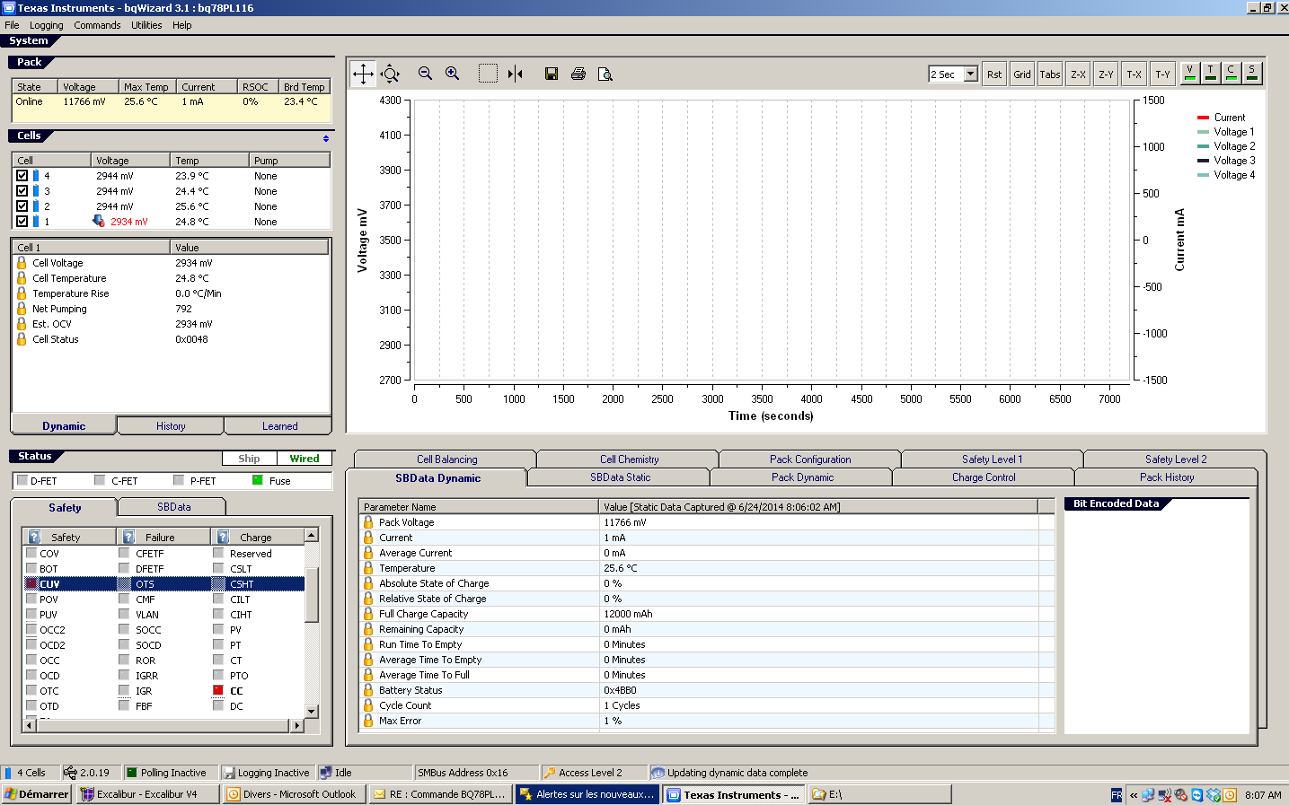

I received the batteries after sales service,  the flag of DC and DC flag is set to 1.
This occurs because the standby power consumption of the product is below the Transition to Idle Current.
The battery is fully charged (CC is set).
The standby mode of the product, slowly draining the battery (DC is set).
The RSOC is 0%.
The flag "Charge Completion" does not turn off and the battery is completely discharged.
The battery is unusable! It seems that this is a bug.

  • The TRM does not state that the CC flag will clear if the pack is discharged with the current set below the discharge current threshold. I had verified it on the bench. I reviewed your .ppcsv file and some of flag control parameters are setup differently from the ones that I was using. I will test your parameters on the bench setup.

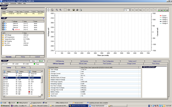

    I just finished the test with a BQ78PL116.
    The transition current discharge is set to '-120mA' to go faster.
    The discharge current was him '-100mA.
    The DC flag (Discharge completion) is this not on, but the result is the same.
    CUV (under Cell voltage) is set to 1.
    The battery is unusable.
  • Julien,
    I was able to reproduce the case where CC did not clear when the discharge current was below the Discharge Current Threshold. You have the FC Clear SOC Threshold parameter set to -1. Set it to a percentage (e.g. 95%) and the CC flag should clear when the SOC reaches 94%.
