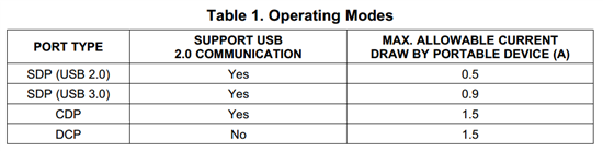

    For both CDP and SDP mode of TPS2546, data communication will be available during connection.
    The difference between these two mode is: SDP only support data communication with 0.5A/0.9A output current; CDP can support 1.5A output charging current as well as data communication at the same time. (You can find this on page 16 of TPS2546 datasheet.)
