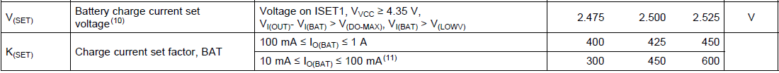

  • I set RSET at 1.22kohm, which gives me around 850mA charging current.
    Can you also elaborate whether KSET and VSET are randomly selected, or not? Because we have no control over it.
  • Hello Sy,
    They are not randomly determined but they are subject to tolerances that are influenced by the output current.
    Looking at Pg. 5 of the datasheet with the charging current you selected the for the BQ24030 the Kset value should be about 425 with a tolerance of about +-5%.
    Hopefully that answer your question otherwise let me know is there is anything else that you are curious about.
