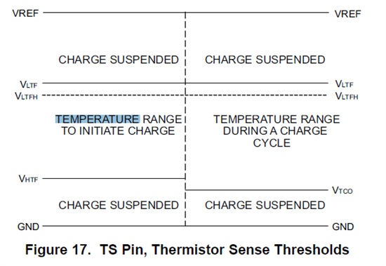

    The important focus for designing your thermistor circuit is that it operates linearly within the charging range for the battery. When the NTC indicates that the system is outside of the acceptable temperature operating range the linearity no longer matters because the NTC information will not be used by the chip when it is in temperature suspend until you return to the linearized region which should cover the charging range for the battery and the operating range for the chip.

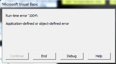

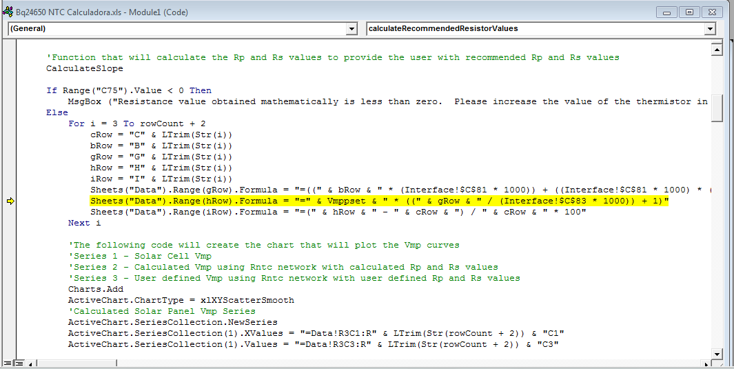

    Hello, I will send you the excel with the same values in the example I send you before and you could check that Rs is not the same. Also attached two pics of an error I have when I put "calculate resistor values".

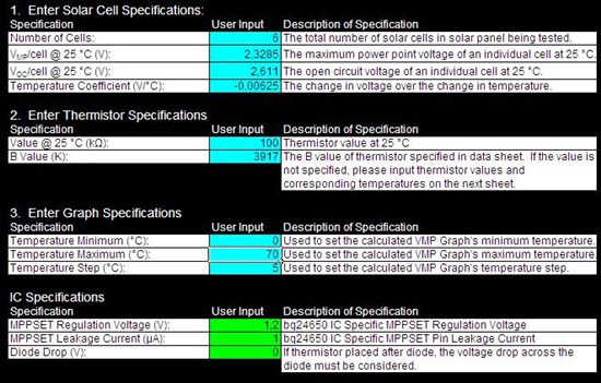

                         I couldn't use the spreadsheet excel, could you calculate the resistor and the graph with this values in the picture:
  • Hello Nahuel,
    Sorry for the delay.

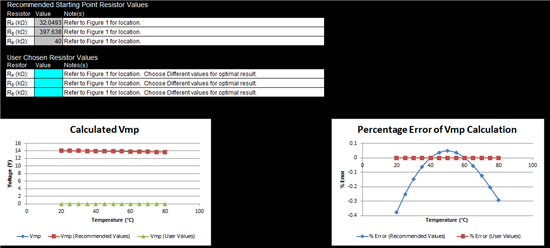

    Here is a screen capture of the excel spreadsheet after I ran it with the values you provided above.
