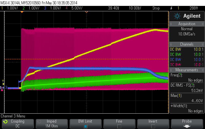

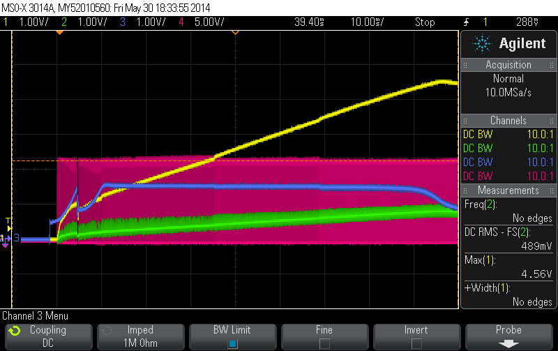

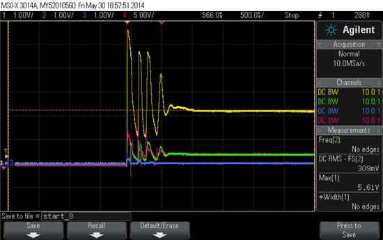

  • Hello John,
    Here are 3 waveforms from  Vout (Yellow), VSNS (Green), COMP (Blue), PH (pink)
    2nd picture is a startup with a 12V Vin and the 3th with a 24V input. (10ms timebase)
    in the first picture you can see how it blew up. (500us timebase)
    I hope you can see any problems.

  • Hi John,
    Altought I couldn't imagine it, there appears indeed a big overshoot on the input capacitors type: MC1210F475Z500CT.
    This should be an alternative for the earlier used the MCCA000587, And even though I can't also find any major differences between both caps I now get all these problems.
    I have also connected your EVM board onto my PCB at the place where my SMPS circuits starts. I have removed my own caps and the chip ofcourse. Measuring the spike on TI's EVM board show a much smaller spike. So I think I am gonna use the same capacitors as you EVM board. Could any difference in used PCB materials also contribute to a bigger overshoot?
