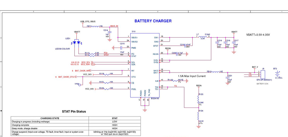

I am facing issue with bq24193 battery charger integrated with imx6s, the driver i am using is bq24190.
When i am charging the battery is shows status "Not charging".
In bq24190_battery_get_status i am reading the ss_reg its value is 0.
What may be the problem, how can i solve this.

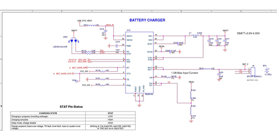

    Here, i attached the schematic of battery charger for your reference.
    And, i tried to read the System Status register (0x08) and Fault register (0x09) both are '0'.
  • Vishwa,
    If your System Status Register is really reading '0' then the IC doesn't recognize a good input source.   Please measure on your board VBUS and VBAT voltages.
    Can you read other registers? If you are only getting all '0' for the registers we need to separate the software driver problems from the IC operation to isolate the cause of not charging.
    Do you have a way to communicate with the bq24193 using the TI supplied software and the USB-to-GPIO box? (The normal way to communicate with our EVMs)
