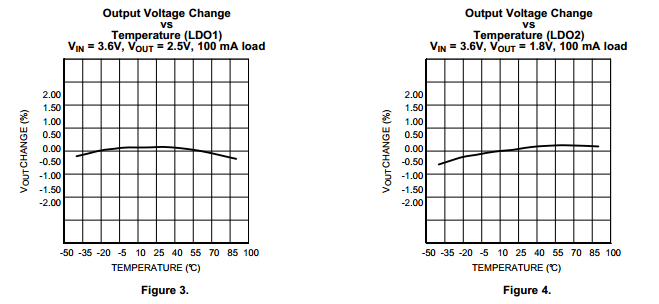

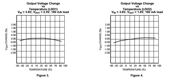

  • No,  our FPGA will draw close 1A most of the times at 1V. Let me clarify my question; LDOs have the following graphs in the datasheet :
    These guarantee that my output will not swing more than 1 percent during the entire operating temperature range. But there is no such a graph for buck converters. Could voltage change of buck outputs exceed datasheet specified 3 percent at any temperature between -40/85 degrees ? My harsh environment is mainly temperature and i am afraid to go outside FPGA's recommended core voltage region.
