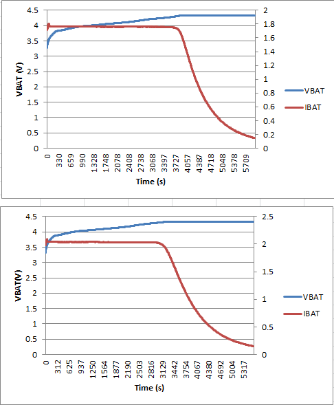

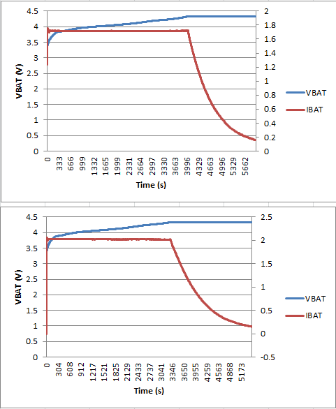

    While I have not obtained any charge cycle data for the BQ24192 I have worked with the BQ24296 which is a sister part and I have worked with the BQ24260.
    The charge time optimizer that is used in the 260 help to sharpen the transition from CC to CV. While the testing I performed with the 296 showed it to perform admirably when it is compared with the 260 the later transfers a little bit more power before it switches control schemes.
    Here are two sets of data that I took for each device with the same battery. You can notice the sharper transition when using the 260 and that reduction in charge time.
