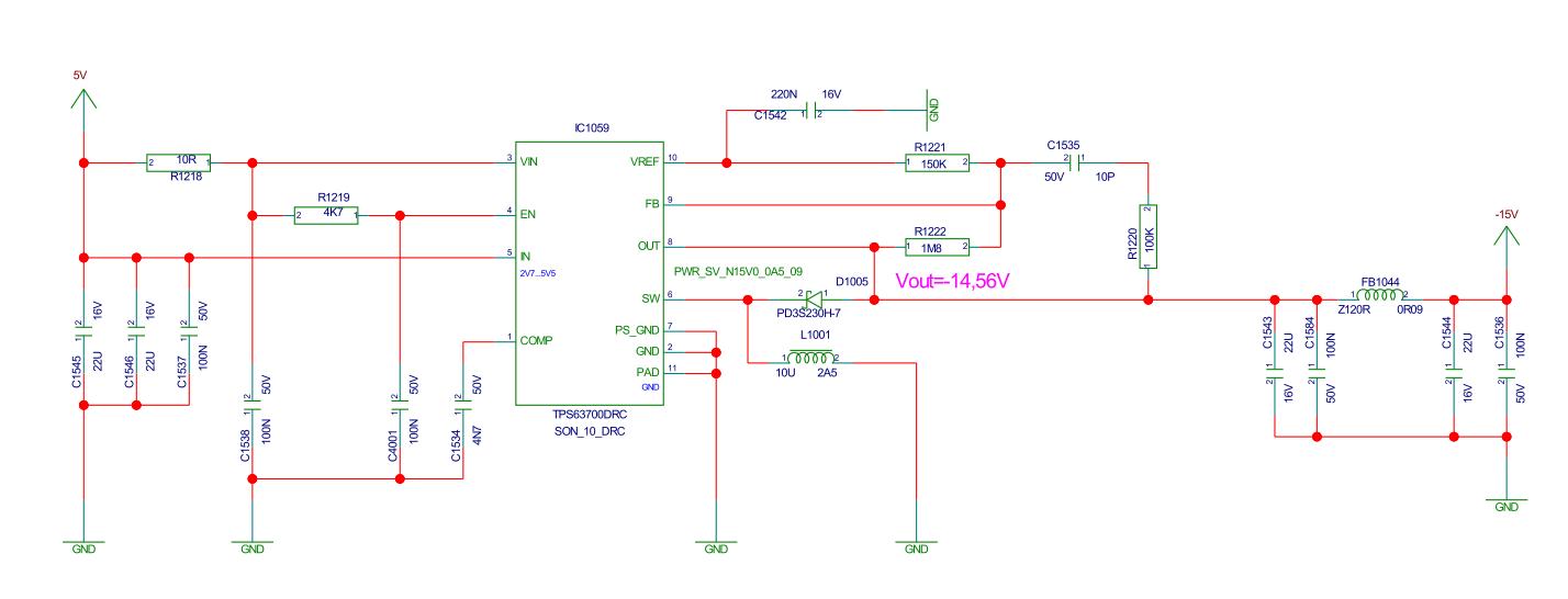

we’ve got some phenomenon with TPS63700 which is working as -15V inverter.
-15V is used as a bias voltage for photodiodes for the purpose of laser energy measurement.

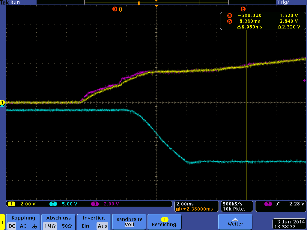

If the power is off for the hole system for about two days, TPS63700 doesn’t want to start at the first push. After turning power off and on again -15V appears properly.
Please see the attached schematic: do you have some recommendations what he have to improve?
Two years ago we had a similar problem in another schematic where EN was connected to VIN (-15V inverter as well). We found a solution by using a rc element for EN, but applying this method in current project has caused another issue.
I would very much appreciate your help.
