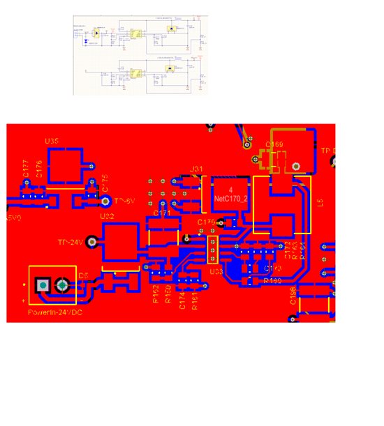

I designed a power circuit based on TPS54332, which takes a 17VDC input, generating a 6VDC output, which is further converted to 4VDC, 3.3VDC, etc through other TPS54332-based voltage converting modules. However, the problem is: for the output which is expected to be 6VDC, only 0.128V is measured. Voltages for the various pins for the TPS54332 are measured as follows:
1. Boot 5.22V
2. Vin 17.44V
3. EN 2.04V
4. SS 0V
5. VSNS: 0.016V
6. COMP: 0.572V
7. GND: 0V
8. PH: 0.128V
the schematics and layout are shown below. I would be very grateful if you can help solve the problem.
Thanks!
