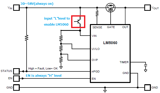

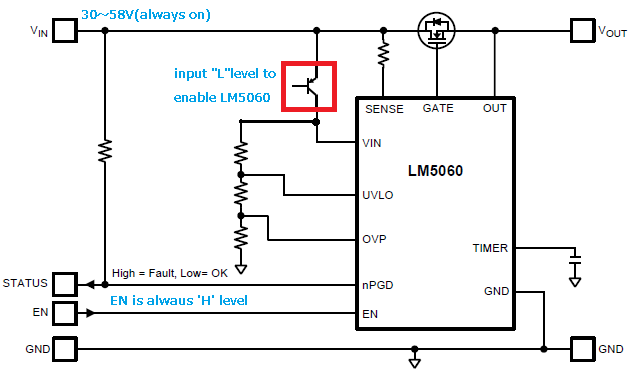

Hi Team,
My customer would like to reduce input current when LM5060 is disabled.
Vin(DC 30~58V) is always supplied in his application and he thinks MAX 15uA(=Input Current at Disabled Mode) shouldn't be negligible.
So, he plans to use LM5060 for following schematic.
Is there any concerns about this schematic?
In terms of "Absolute Maximum Ratings", It seems possible to use.
Yaita
