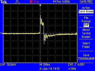

I got similar problem when the load decreases. I used the EVM board:
Load is 0.5A, output voltage is set to 3.3V, Vin is 12V (short wire, 10A power supply).
SInce I read this post, I already put a big cap of 100uF on the input and additional 100uF cap soldered on the terminals behind (cannot see in the picture above. Here is what I get: (load is 6.8 Ohms which means about 0.48A)
Please advise how to solve the problem. Increasing Cout does not help so much.
  • It is not clear what your problem is.  Could you rephrase your question?
    As well, I don't think adding a wire onto the FB pin is a good idea as this will pick up noise.

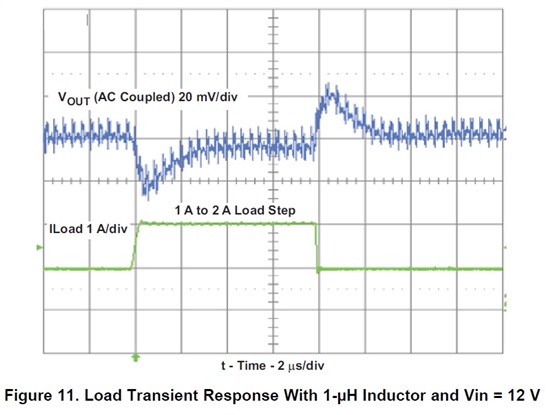

  • TI declare in the EVM datasheet that the transient reponse is 20mV when the load is connected and 20mV when the load is disconnected:

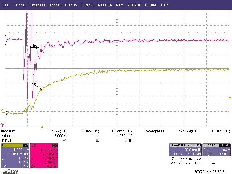

    This graph is taken from the EVM datasheet http://www.ti.com/lit/ug/slvu437a/slvu437a.pdf
    So why do I get a transient of 100mV when I disconnect a load of 480mA (which is much less than "1A to 2A" declared in this graph?
    When I bought this evaluation board I saw that graph and only because of the low transient I spent 100$ on purchasing this evaluation board (including shipping). Now I see that the load transient is 5 times bigger so I'm asking what should I do in order to get the same transient response as in the datasheet.
  • That waveform you show loos like it is due to the inductance of your wire and an instantaneous load dump.  We usually measure the load transient with a controlled slew rate.  Int he waveform from the EVM users guide it is about 400mA/usec.  In that case the transient response will be as shown.
  • Yes, the ~50 nsec wide pulse in your screenshot is not the transient response but is just noise picked up by the probe.  You need to measure the voltage change with a low inductance probe right across the output capacitor.

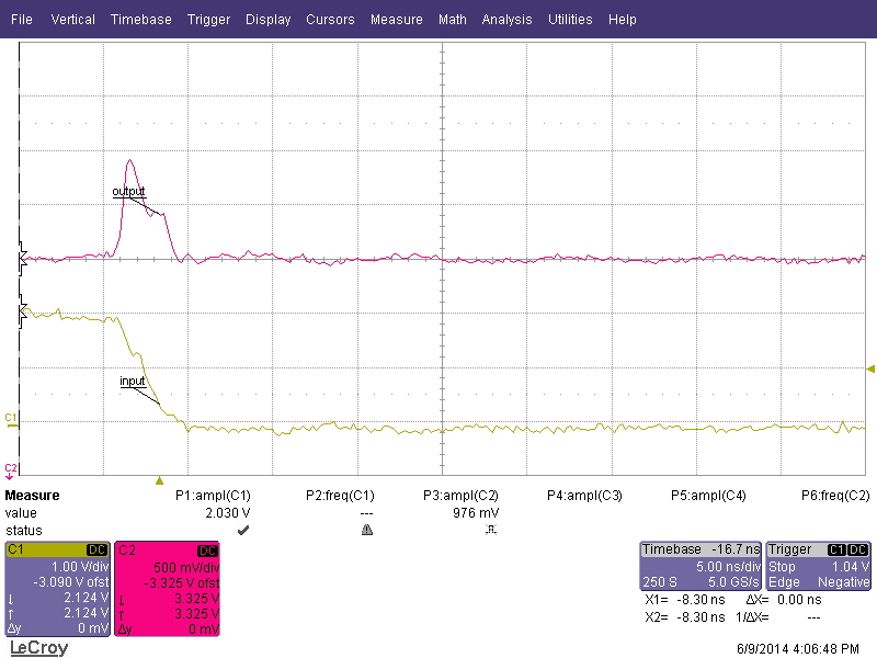

  • I reply to Chris and John:
    I read your comments about inductance and noise and I thought that maybe because my load was inductive, the scope probe picked up some noise which was induced by the wire wound resistors.
    Therfore, I built a new setup:
    The load is 3.5 Ohms, made from 6 SMD resistors 1206 size of 20 Ohms each.
    THis load cannot handle so many watts but for few seconds it works well. It also has no inductance.
    As for the oscilloscope and the probes: I changed the oscilloscope to LECROY model 64Xi which is a 10GS/S , 600 MHz oscilloscope. I used active probes model HPF1500 which are for 1.5GHz with 0.7pF and 100 K Ohms resistance. THere is no inductance at all. THe probes are mounted on pins soldered on the capacitor of 100uF that I added at the output (Tantalum, low ESR, 150 milliOhms) and on the load. THe channel connected to the load is the trigger channel (what is called "Input" on the pictures that would follow). The "output" is the voltage on the Tantalum cap which I added. Here is a picture of my new setup:
    Here is teh picture when the load is connected:
    Here is a picture when the load is disconnected:

  • Thanks for explaining your system requirements in more detail.  We have no limit on the slew rate at the output.  John was just stating the test conditions used for the UG waveform.  We cannot test every possible combination of load transient and slew rate, so we just show a few examples.  Thank you for testing an EVM to get the desired performance for your system.  This is the right way to do it.
    Your waveforms are too short a timescale to be showing the transient response.  5nsec/div and 20nsec/div is too fast for the IC to even see the change at the output and respond.  So, what you are measuring is either noise or the drop across the output cap's ESL.  You are not measuring the IC at all.  See the timescale for the waveform in the UG for an example of how much time in takes to view the waveform.
    The inductance we are concerned about is in your measurement point.  You are using a good probe and now measure across the output cap in the proper place.  Improvements to your setup might include measuring across a ceramic cap instead.  This is a lower ESL component and also allows the scope probe 's tips to be closer together--this reduces the loop area created by the probe and this reduces the noise pickup.
    What are the load transient requirements that you need to meet?  You said 12Vin, 3.3Vout.  What is the load current step from and to?

  • The timescale on your waveforms is 5 or 20 nsec/div.  And the rise time of the 'input' signal (which is your load current?) is around 50 nsec.  So, your rise time is very fast.  This is ok for us.
    Yes, many types of end equipment have rise and fall times this fast.  But this energy comes from the capacitors.  From I = C dV/dt, a small dt in the nsec range will not cause a significant dV on the voltage bus.  It takes some time for the output to drop, the regulator to see the drop and respond, and then for the voltage to come back.  This is a load transient test and is showed with a wider timescale as we have in the datasheet and user's guide for the EVM.
    Is your load step 0 mA to 900 mA?  I ask because you used 0.5A in your first post.  We can take some load transient responses with your specs.

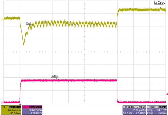

    Following you can find the tests done on the EVM:
    1 - Load transient from 0 A to 900mA
    2- Load step from 0 A to 900 mA, added 100uF output cap:
    zoom in picture:
    Best regards

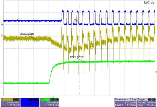

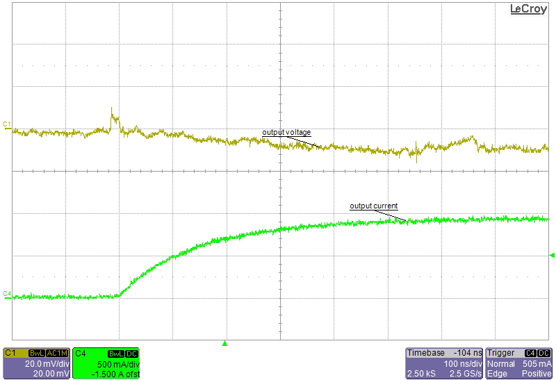

  • I followed your indication to test the EVM, this is my set up:
    - 12 Vin, 3.3V Vout, 3.5ohm power resistor as load ( ~ 0.95A)
    - I use a current probe to measure the load current and a low inductive probe on the output ceramic capacitor for Vout, and switched the load manually.
    Follow the results:
    Zoom in:
    We have a SR about 800mA/500nS, and with our set up we don't experience overshoot above the 20mV as well as the EVM app note.
  • Whether the slew rate is 200 nsec or 2 nsec won't significantly affect the resulting output voltage drop.  At these speeds, the first voltage drop is from ESL.  This ESL is from the output cap, board trace, and measurement point.  ESL in ceramic capacitors is very small.  If smaller ESL is needed, low value (0.1uF, etc.) are used since they have very high self-resonant frequencies.
    As an example, consider the first waveform you posted in your post with 3 waveforms.  This is about a 300mV drop in about 2 nsec.  For the 22uF output capacitor to supply your 1A for 2 nsec would result in a voltage drop (from capacitance) of less than 1 mV.  So, this drop must come from ESL in the component or measurement setup.
    Try adding a small ceramic at the output and measuring across this to get a cleaner measurement.  In any case, it is not the job of the power supply to respond to 2 nsec pulses on the output.  This is actually impossible considering control loop bandwidths and output inductors limiting the slew rate to the output.  This is the job of a cap.

    But I am confident that the spikes you see are not real.  It looks like you are probing across the tantalum cap and taking the load current off of his exact point.  There is likely some ESL or noise pickup in your measurement.  Try probing across C3.  This is right at the output of our device and is where we have measured and see no spikes.  These high frequency measurements can be difficult.

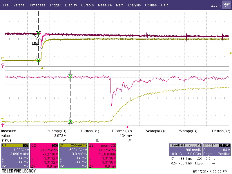

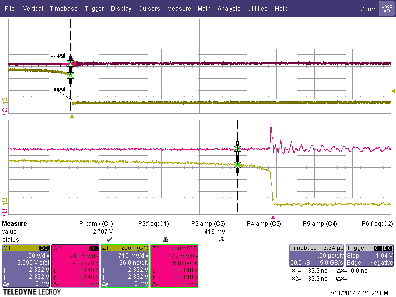

  • I decided to give it another try and after I removed my tantalum 100uF cap, I installed a "tower" of 5 ceramic caps on the top of C3, added another 100nF low ESR cap and moved my probe and the load to C3. Here is my current setup:
    So you are right. If I probe across C3 and not across the output terminals, I get much better results. When connecting the load:
    When disconnecting the load:
    In order to avoid any comments about my "5nSec pulses", I adjusted the oscilloscope to a relatively slow sampling rate so you can see the results in a slow sampling rate on the top 2 screens and with a high sampling rate on the bottom 2 screens.
    As you may see on the top screen on the red graph, there is a high amplitude short pulse and after it there is a very long overshoot. THis ling overshoot is what we see in your oscilloscope curves. We see only this low amplitude overshoot because your oscilloscope does not sample fast enough and it does not capture the short pulse.
    PLease note that the oscilloscope has 2 time bases: THe time base on the right hand side (200nSec or 1 uSec) is for the top
    Therefore, my conclusions are:
    1, The PCB routing of the EVM board is bad. You should remove the output terminals to the bottom side of the board, below C3. You should also solder C3 on the board and make space for soldering 5 more ceramic capacitors. THe 2 output terminals should be below all of those caps.
    2. Your oscilloscope is too slow and it is missing the short impulse at the beginning. It is not a problem of a fast or slow finger... (sorry but mine cannot be replaced...)
    3. The ceramic capacitors do not solve the problem completely. They just reduce it.
    4. The TPS62130 is not well compensated for high load and cannot be compensated because it cannot allow an external capacitance of more than 200uF. I hope that all of you understand that using 10 ceramic capacitors in order to get those 200 uF and reduce the spike much more is not cost effective and it takes a lot of PCB space. This bank of capacitors cost at least $1.80, no matter if I built it from 22uF or 33uF or 47uF or 100uF caps for 6.3V or more.
    I wonder if you got any other cost effective solution?

    On the oscilloscope plots posted now, channel 1 and channel 2 got one time base (200nSec or 1 uSec) and channel Z1 and Z2 got another time base which is noted in the square named Z1 or Z2 (13 or 36 nSec per division).
    The lightened area in the top 2 channel is shown in the zoom picture on the bottom 2 channels (Z1 and Z2)

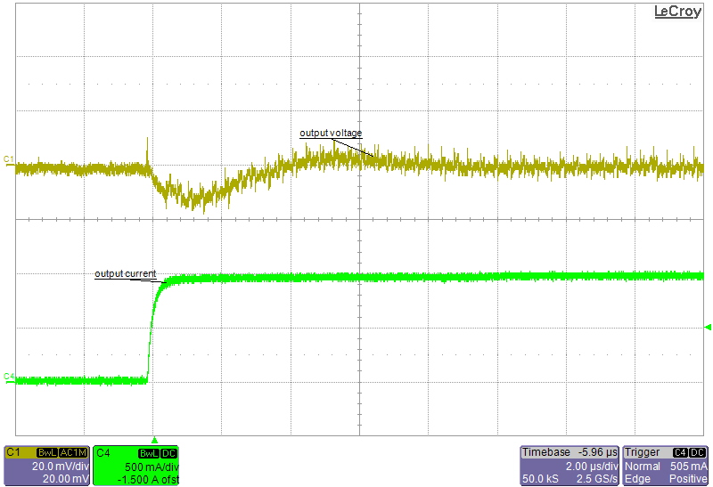

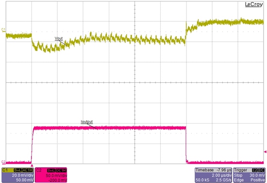

    We showed a BW limiting to show a cleaner waveform with less noise, BW limit helps eliminate the very large magnitude and short time pulses, which are noise and mainly depend on how the probe is held, what angle etc.  Noise is influencing the measurement.  Also it is clear from my plot that the probe picks up also the SW signal.  That is noise as well.
    Follow you can find the waveforms took without BW limit:
    Zoom in:
    New waveforms without BW limit show no spike at turn on of load, the SW node in the waveforms (short time) does not move since the IC cannot respond in such short time, that’s why I can’t assume a chip fault or a contribute of the IC to generate that spike.
    You don’t need to add 5 caps on the output unless his application requires very low voltage droop during the load transient response, moreover ceramic caps are the best combination of performance and cost.
    At this link  you can download TINA simulations which show the impact of ESL, as you can see the ESL alone causes this droop. Also you can download a trial version at TINA at this link www.ti.com/tool/tina-ti
