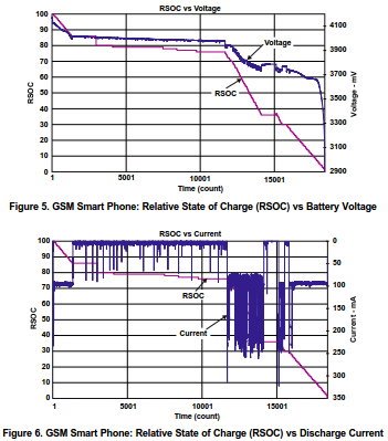

What if the current is pulse-like? There are applications like motor-driver, GSM pulse and alike in which high-state current is dozens or hundreds of times larger than low-state, and it is possible for |AverageCurrent( )| < |Quit Current| to be true over entire period (say several millisecond, not limited to GSM cases). So if the OCV readings are attempted based on AverageCurrent readings, then what happens if the readings coincide with moments of the high-pulse (and high voltage drop)?
In SLUA450 p.3, an iterative algorithm is outlined
“If the current during the OCV reading is non-zero, then an IR correction is done. The first iteration of DOD is found from the uncorrected OCV reading; then the resistance value is found from the R(DOD) table and used to correct the OCV value as OCV`=OCV-I*R. Then, the corrected DOD is found from OCV`. This method achieves the best accuracy if the current during relaxation mode is below a C/20 rate. This is why it is recommended that the DF.Quit Current not exceed C/20.”
Clearly the designer are aware of the cases of such coincidence, however the recommendation here of keeping current below C/20 simply doesn’t apply to pulsing cases, because current cannot be controlled below C/20.
