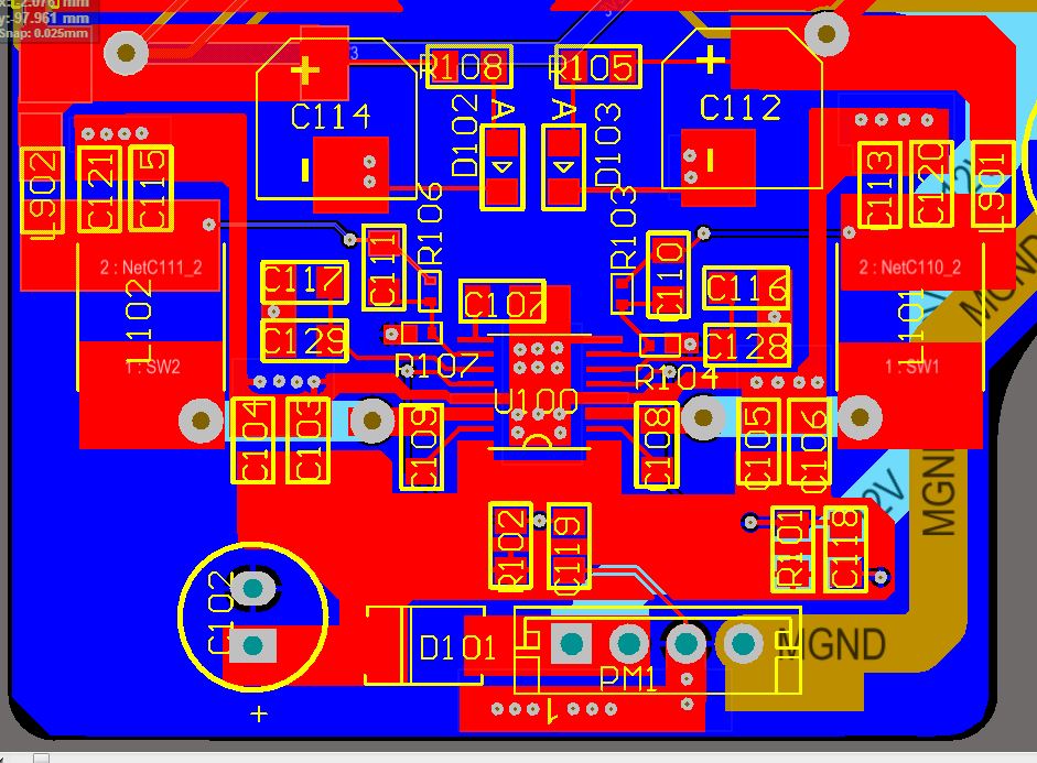

We have been trying to use TPS54295PWP in our design, and there are a lot of issues with the ICs. We have built around 15 boards and 4 to 6 boards failed with the following symptoms:
1. Output SW1 or SW2 pin shorted to ground. (Found up to 3 cases in our First Article Test Build. We have carried out detailed experiments, peak current in the system never exceeded 500mA in any case).
2. The system does not power up. (Found up to 2 cases in our First Article Test Build, the VREG5 pin measures around 5.6 V and the power supply just does not wake up).
Is there any special consideration required for the design apart from the WEBENCH generated schematic and PCB Layout guide lines in the data sheet?
I have attached the Schematic accordingly. Please let me know if you need any detailed information on the failure.
We need to resolve this issue ASAP or we have to move on to select other type of Switch Mode ICs in our design.

  • I can see some issues with your design.  For the input voltage rails, you need a minimum of 10uF x5r or x7r ceramic capacitance directly coupled to the VIN1 and PGND1 and VIN2 and PGND2 pins.  That is 2 total, one for each side.  C110 and C111 are too big.  I would start by just removing them or using 10pF for each.  Your slow start time is very long.  I would reduce C128 and C116 to 10nF total.  Same for C117 and C129.  The extra filtering on the output may be interfering with the converter.  Try removing L901 and L902.  Se if both output start up properly.  Let me know your progress.

  • I have attached the layout as well for your reference.
    Thank you.
    Aung

  • The layout for dc/dc converters in general is critical.  You have to keep the circulating current loops short and use wide low impedance traces.  This is especially true for the input bypass capacitors.  All the switching ac current go thru them and it is critical to keep the parasitic inductance low.  High voltage spikes are the usual cause of internal FET failure.
    I suggested that you remove L901 and L902 completely to isolate the TPS54295 circuit from the external load and additional capacitors.  I think you would be best to get the circuit up and running reliably first, then troubleshoot the down stream problems.

    I have exactly follow the layout guide lines, i don't think we have layout issues.
