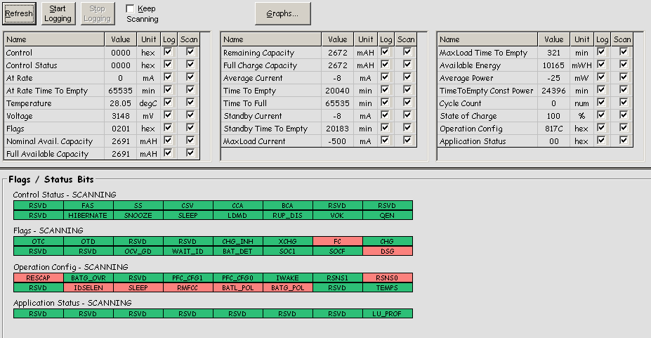

2) On the second device, everything works fine when using the Impedance Track Configuration Wizard. For calibrating the battery, I discharged it to empty and waited for 5 hours. After that, I clicked the "Initialize Impedance Track Algorithm". The IT Enable turned to 1, which is fine, but the VOK and QEN bits stayed 0. This means Impedance Track won't work, right?

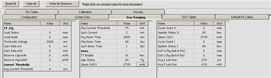

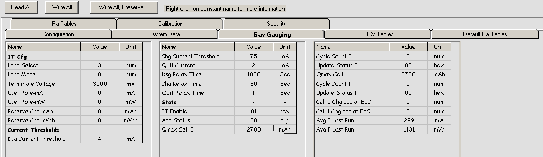

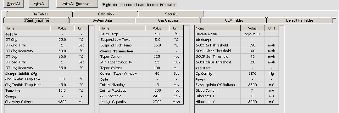

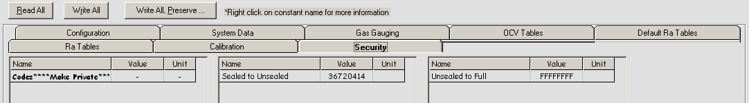

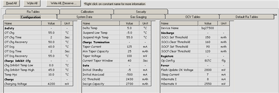

I made some screenshots of my configuration. These were taken after I initialized the Impedance Track Algorithm.
Could you please tell me, if there is anything wrong about it?

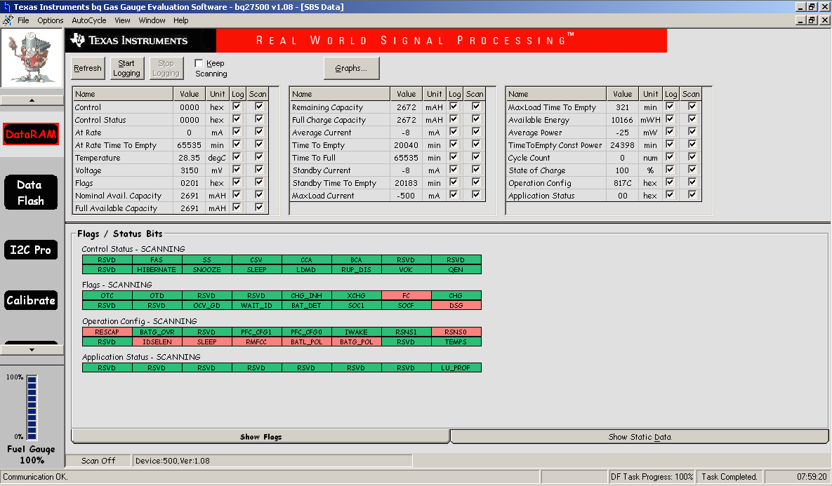

    Can you send a screenshot of your entire EVSW screen, please?
    Your Control Status register is showing all zeros which is not very common so something might be wrong.  A screenshot showing the title bar and the bottom bar might give us some clues.
    I might also recommend that you look at the bq27510-G3 instead of bq27500.  It has an integrated LDO and has been updated much more recently than bq27500, which will probably never get an update again.
  • Here is a screenshot of my EVSW screen:
    I'll try to upgrade it to FW Version 1.30 now.
    Edit: my EVSW version is 0.9.92.
  • Hi Julian,
    Indeed your screenshot is showing v1.08 which is the original bq27500 FW.  Please follow the instructions in SLUA453A to upgrade your EVM to bq27500-V130.

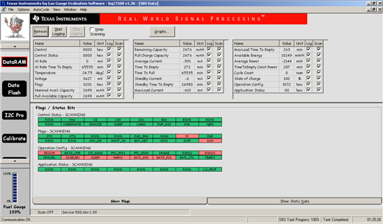

  • I did upgrade it to v1.30 now, but Control Status remains the same - all zero.
  • Can you please post a screenshot showing the DataRAM window right after power-up of your EVM?
    Do you mean sending IT_ENABLE still doesn't set QEN?  What about the IT Enable parameter in DataFlash?  Does it get changed to 1 after you send IT_ENABLE?
  • Hi dMax,
    here's a screenshot of the DataRAM window. It's not taken right after power-up, but it didn't change since then. In the screenshot, I'm doing the first discharge in the cycle learning process (Step 5 in bqEASY). By the way: I am not using the bq27500-EVM, it's on my own hardware and communication to my host processor via I2C is working fine.
    After sending IT_ENABLE, neither QEN nor VOK get set. The IT Enable parameter in DataFlash gets set successfully when sending IT_ENABLE.
