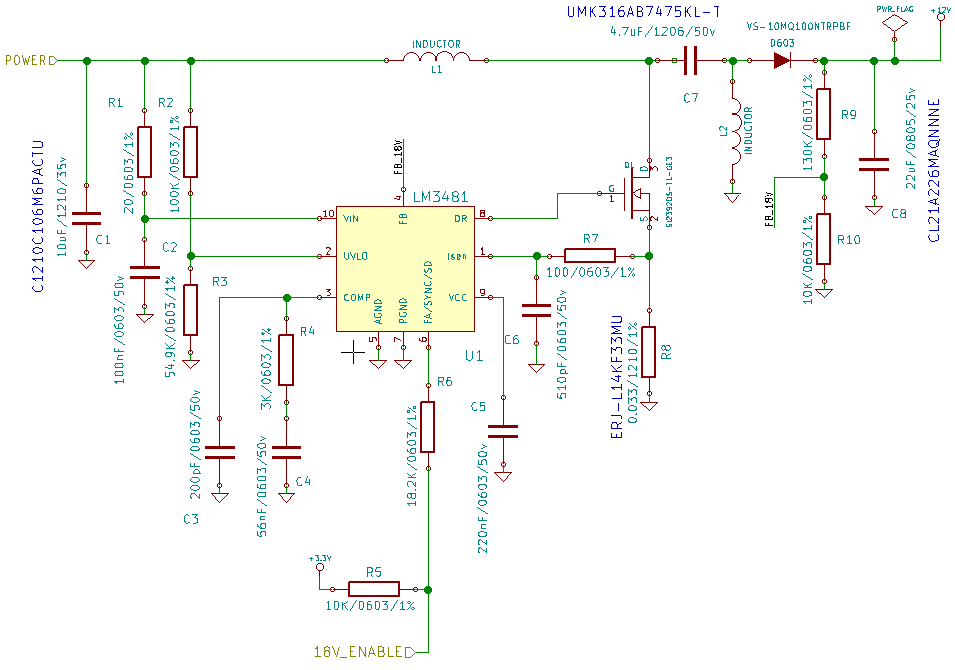

I'm making a SEPIC regulator with LM3481 and I have some questions about minimum load and inductors.
The parameters of the converter:
Vin: 5-30v
Vout: 18v
Load: 3mA to 300mA
I'm trying to find the right inductor values, since I don't want to see any OVP issue this time when the load is 3mA.
The circuit:
Acording to the datasheet on page 22, I found L2 and L1 values as high as 3mH and I found it too high! don't know if it is right.
I'm using a frequency of ~920KHz.
Someone could help me to find the right values of these inductors? Most of the time this circuit will have a load of just 4mA, so the voltage of it must have the ripple as low as possible.
Thanks!
    The inductors would need to be very large to make sure you don't enter discontinuous conduction at light loads to avoid the part going in to the min-ton and OVP mode. I am not surprised to hear that you'd need 3mH. An alternate method to avoid this is to put in a dummy load that will just sit and burn power. This will pull more current and not let the device go in to burst mode. But the efficiency of the system will take a hit. Unfortunately, there is no easy way out of this.
    Akshay
  • Hi Akshay,
    L1 > ((Vinmax - Vq) . (1 - Dmin)) / 2 . Ioutmin . Fs
    L1 > ((30 - 0.1) . (1 - 0.375)) / 2 . 0.003 . 920000
    L1 > 0.0038 = 3.38mH
    L2 > ((Vinmax - Vq) . Dmin) / 2 . Ioutmin . Fs
    L2 > ((30 - 0.1) . 0,375) / 2. 0.003 . 920000
    L2 > 0.00203 > 2.03mH
    Are these inductance values right? Or am I mistaken some calculation?
    Further I will calculate the current values.
    Thanks!
  • Hello Bruno,
    You should be using the minimum value of Vin and the worst case duty cycle at min Vin. Also, if you are using separate inductors, I'd suggest that you make the secondary inductor twice the primary. This helps stabilizing the voltage across the SEPIC cap when you have a transient. By the way, if you want another easy calculation, just visit coilcraft.com and use their SEPIC power inductor calculator tool. They will even suggest actual parts to match your requirements. I hope this helps.
    Akshay
