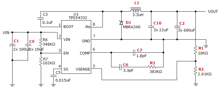

I have a startup problem with TPS54332. Vin range in our system is 4.4-7.5V and Vout from TPS54332 is 3.8V, nominal 100mA with peaks upto 2A.
This is the initial schematic. R200 and R202 results in 3.8 startup, which is problematic since 100% dutycycle is not possible.
I have since recalculated these values and changed it to R200 = 270k and R202 to 101k. This should according to calculations give me a startup voltage of 4.31V.

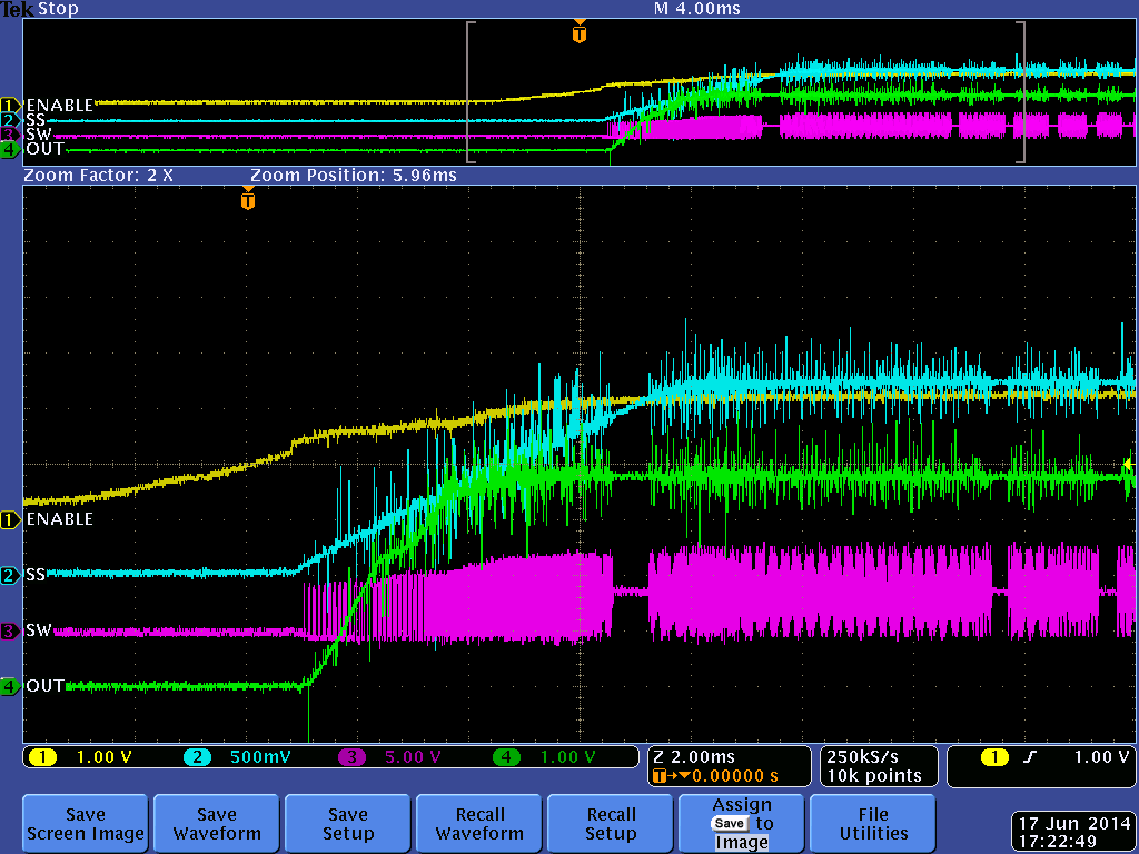

The problem I am experiencing is that the converter does not startup unless given approx. 5.8V Vin. My solution will be using 4x AAA NiMH batteries as backup and thats 4.8V when stacked so this is a big issue.
Can anyone guide me to find a solution?
Thanks in advance.
