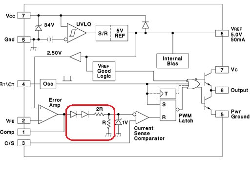

I am doing a tolerance analysis for a current driver circuit using UC1843.
Can I get the specification/tolerance of the diodes and resistors (-55degC to +100degC) in the following figure?

  • I have the same question but am getting no direct answer. If these are truly silicon diodes, we should expect a variation of about -2mV / deg C. If we start with an assumption of 25deg giving 0.7V per diode, and a delta T of 170 degrees ( 100 degrees hotter and 70 degrees cooler), the delta Vf of each diode would be spanning 340mV (140mV more at cold and 200mV less at hot). If the 25 degree Vf = 0.7, we should approximately vary from 0.84V at -55deg to 0.500 at 125 deg C. Of course these drops would be 2X. On top of that, the forward current and Is would be a factor in the -2mV/deg C approximation so this would not be exact. Also there would be process variation to stack on top of that. Unless the UC1843 uses some form of temperature compensation strategy, this could be a pretty hairy error component to your driver.
  • Why is this accuracy important? The error on the diode and resistor divider will be compensated by the voltage level on COMP, which is normally generated based on the integrator. Unless you are talking about the headroom tolerance. As long as you get enough headroom, the tolerance on these devices should not affect your operation.
  • Not using the integrated feedback loop and therefore the diodes are not inside a loop for my application.   Therefore in this application, the variation is relevant.
  • I will follow up on your querry and provide you input on it.
  • According to the test group, statistics show that the diodes have a mean of 0.633 V and a standard deviation of 0.006.  We do not measure at temperature so we don't have any data on the temperature coefficient but the -2 mV/C is typically a good rule of thumb.  As for the resistors, the absolute value isn't imprtant but the ratio is and that is very consistent and as shown in the block diagram.
