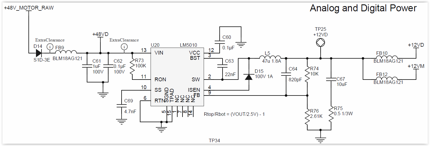

I am working on a LM5010 design taken primarily from Webbench and I am getting odd behaviour:

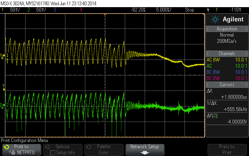

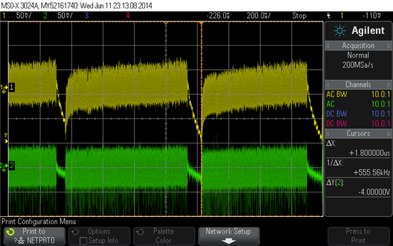

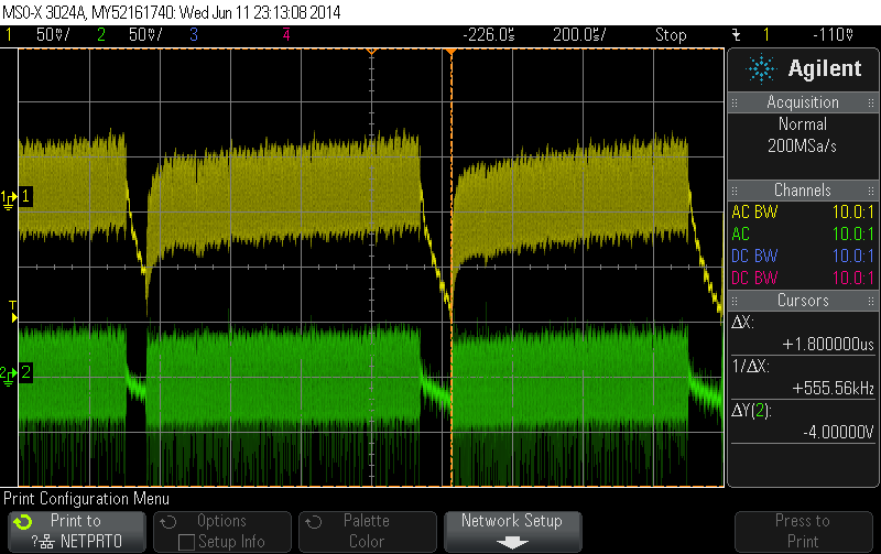

@25V: around 12.3Vout@1MHz (toff ~350ns) - odd "stopping" behaviour shows up every millisecond or so and lasts for ~100 us
@40V: around 12.3Vout@1MHz (toff ~ 700ns) - stopping behaviour happens around every 200-300us.
A few things I have been investigating: I originally started with a non-shottky diode and based upon info from the forums, I switched to a fast schottky, though maybe not optimal (STMICRO STPS3H100U).

-outside of the shown circuit there is over 20uF of ceramic capacitance through the shown ferrite beads.  The beads may poorly combine with the caps to create a bad harmonic frequency?  Maybe the beads don't provide enough DC resistance to keep the caps from oscillating the output...

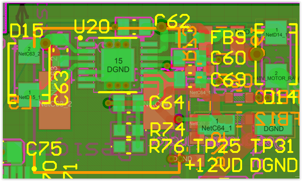

-The inductor is up against the power plane (12V) rather than a ground plane.  Could this cause issues?
-Maybe my layout itself is bad - I have a hard time assessing this completely.

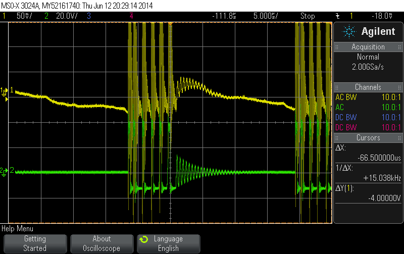

  • Yes, I was able to verify that the circuit in those cases switches to DCM (discontinuous current mode).  The voltage output (yellow - AC) and the SW pin voltage (green - AC) are shown below.  I modified the circuit to so that C64 (to couple the ripple into the feedback pin) was increased from 0.82nF to 4nF.  This increased the rolloff frequency from ~100kHz to ~25kHz.
    My understanding of ideal "discontinuous current mode" is that it is like a rock skipping - single pulses that spread out a little bit more when current decreases.  Is that correct or is the behaviour seen below of a few pulses separated by a longer wait what is to be expected.  Is the amount or ripple @ 2MHz when DCM is entered expected?
  • Hi John,
    The DCM behavior can be graceful degradation of frequency or burst mode depending on design. We think LM5010 has burst mode behavior.
  • Thank you for the input.  I was able to place a 150Ohm resistor on the output (~80mA) and the DCM mode went away.  As it is right now with or without the load, it is very usable.  Thank you very much.
