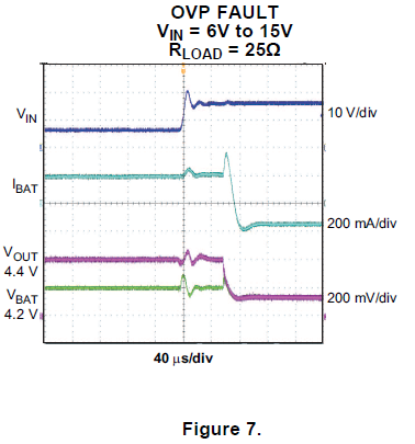

    Are you asking if Q2 will open if the input voltage exceeds the OVP value? When an OVP case is detected Q1 will open to protect the downstream system and the battery but the OUT will be shorted to the battery through Q2.

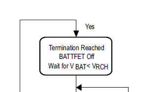

    However if you are asking if Q2 opens when the battery charging has terminated by finishing the current taper while the battery is at the regulation voltage the answer is YES. Looking at the flowchart on Pg. 20 of the datasheet you can see that the BATFET is turned off if the charge has terminated while the adapter is still attached. However once the adapter is removed or the battery voltage dips to low the BATFET will close again.
