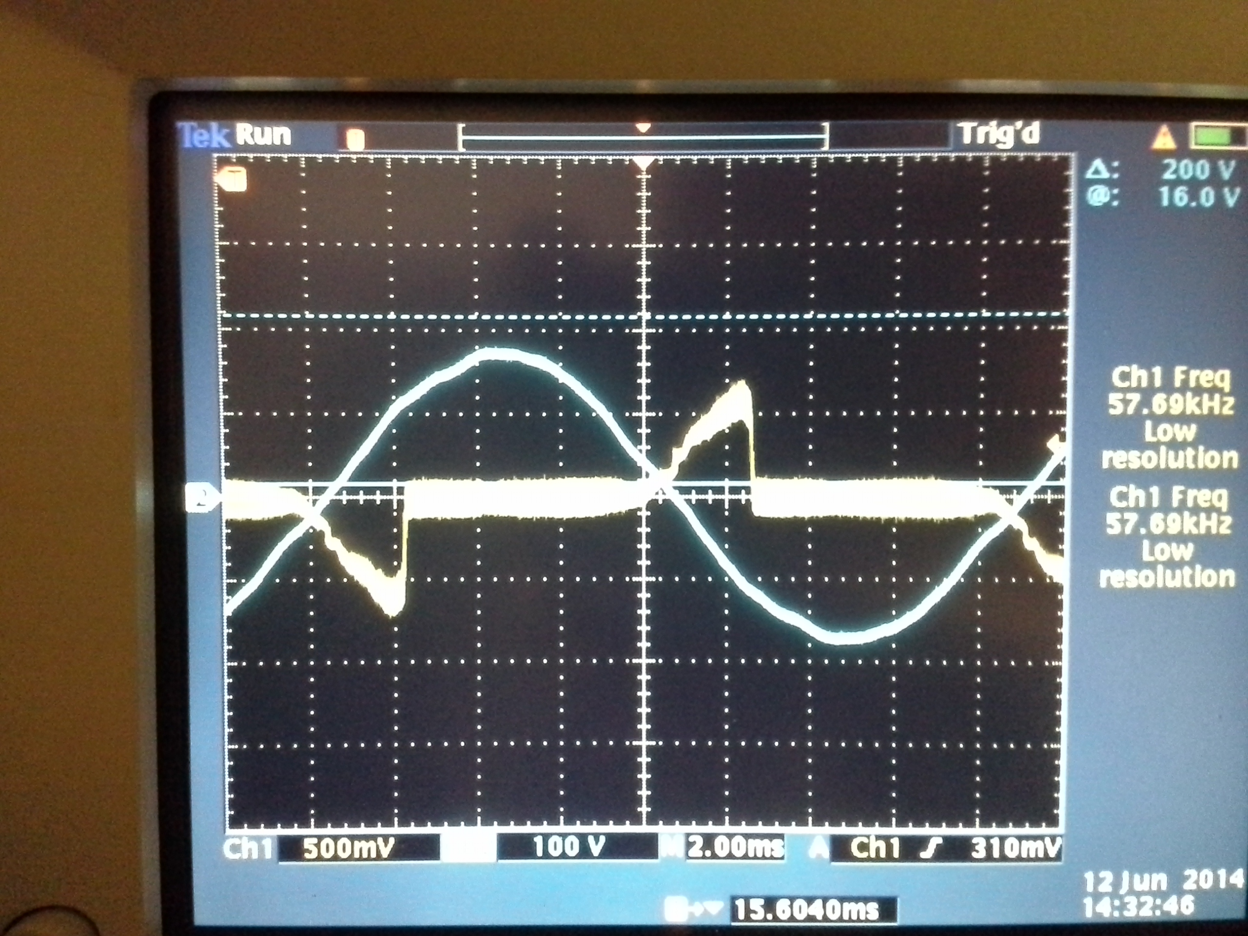

Blue is Vin AC, Yellow is Iin AC.
Everything appears fine for the first quarter of half the cycle, then the current goes to zero.
Vin is 110-120 VAC. Output is around 380 VDC @ 50 Watt. The peaks get higher and shorter in duration as load is increased.

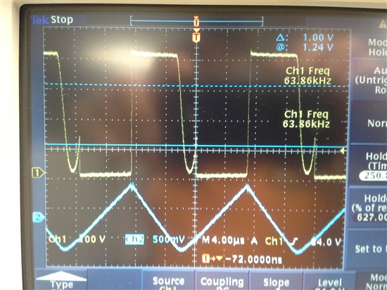

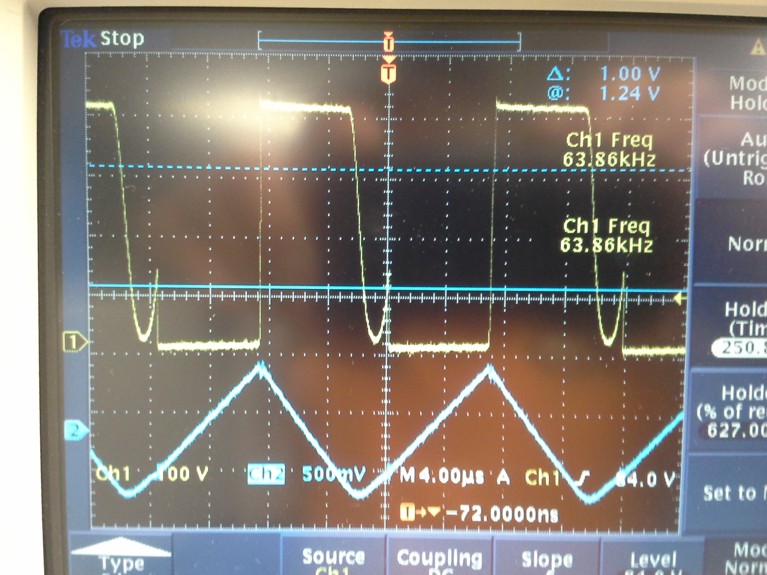

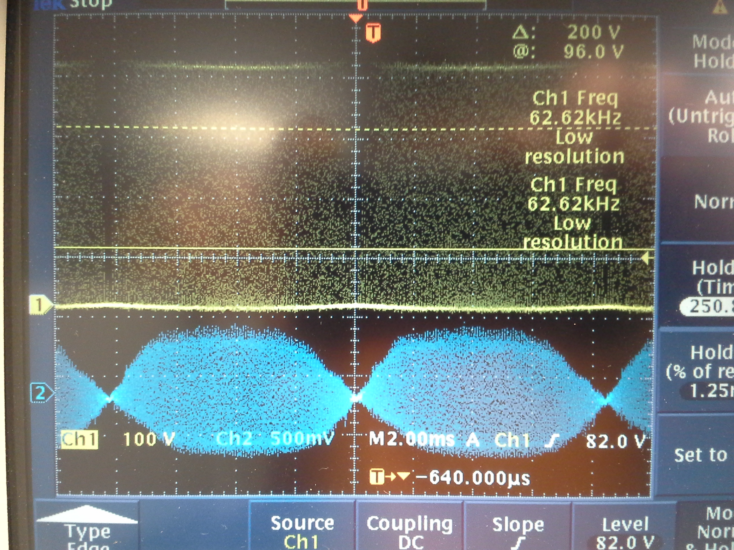

What are the waveforms on the Icomp and Isense supposed to look like? I don't see those shown anywhere in the datasheets.
Oddly, if I use an isolated 70-80 Vrms, 500-600 Hz AC supply, the input current becomes sinusoidal and in phase with the input voltage . Not sure if this is related to the input voltage being lower, frequency higher or the isolation.
