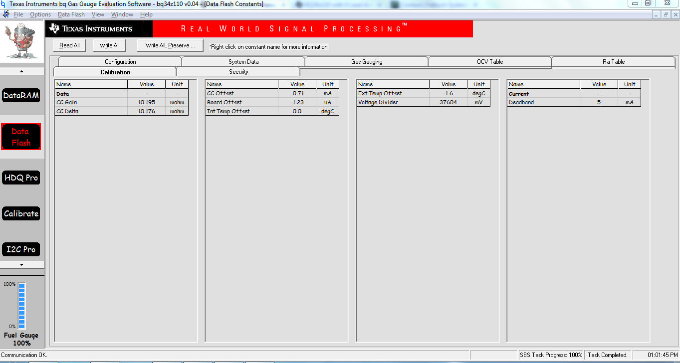

I have received a BQ34Z110EVM and also EV2300 USB converter and i am trying to configure the EVM to work with a 110Ah 24v battery pack.

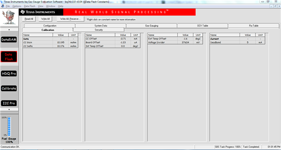

I have completed the calibration section OK.
Is there somewhere i can set the number of cells (ie 12)?   Also, i cannot set a mAh value any higher than 32767mAh.
Not 100% sure what parameters need to be setup, but the system will run under the following condistions.
Charge current 0.5-4.5A  and discharge current will be 0.75A -3A.   The load is resistive (neither constant power or constant current).   I would want the battery to be regarded as empty when the voltage is 22.00v or below.
I would appreciate any help you can offer.
  • Oops - just spotted the "Number of series cells" and changed this from 6 to 12.
    I think i need to enable the X10 mode, so i think i need to set the underlined values:
    Cell capacity mAh = 110000 /10 = 11000
    Cell capacity mWh = 110Ah x 24v x 1000 / 12 / 10 = 22000
    Cell BL = 22/12 x 1000 = 1833
    Not sure what to do with SOC1 Set and Clear, SOCF Set and Clear
    Dont think i need to do anything with Charge Termination, Charge Inhibit

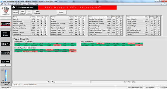

    I think ive had good success with the manual scaling.   I now have the batteries on the anticipated load and its giving the results in minutes which i would expect so thats all good.  I have no set the X10 bit as im not sure exactly how, but i have set the Design Energy Scale to 10.
    Have got a few queries which im not clear on.....
    How does the x10 affect deadband and resolution?  I assume the 1mA resolution is now 10mA and the deadband is now 30-50mA as opposed to 3-5mA (with the EMV)?
    State of Charge 0x02/0x03.  I read 2, size 2 and get 6200  (0062 = 98% - correct, as reported)    I have never seen a decimal percentage, i assume its only giving integers and i could safely just read 0x02, size 1?
    I see in other posts you indicate a constant resistance is OK to use for the initial set-up, however my actual load in service is more constant resistance than constant current and is certainly not constant power.  I would assume in this case the best model to use is the constant current model?
    Last one for now....   I had set the maximim load current initial value to -100mA, however this is still reporting as -500mA and the time is being calcualted on this value, why is this?
    Stuart
  • Stuart,
    Scaling will affect all current and capacity parameters, so the deadbands are a affected as well. The SOC is only reported as an integer, so the useful data is in the first byte. You can just read one byte from the device. Load Mode = 0 should work okay for your constant resistance load. I am not sure about the current reporting discrepancy. If you are using 10x scaling, then did you use a -2000mA discharge current and enter -200mA in the actual current field?
