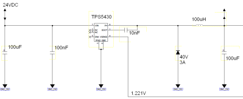

I am using a TPS5430 with the following parameters:
Vin = 24Vdc
Vout = 12Vdc
Iout = 0,5A
The components surrounding the regulator are the ones suggested by Webench simulation, and the schematic is attached below.

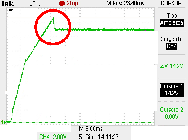

My problem is: when the input voltage is provided (at the startup), the Output experiences an overshoot (about 2 V, see attached image): Vout reaches 14 V, and after that, it sets to desired 12 V. Please see the attached image below.
Please, could anyone give me some suggestion on how to eliminate that undesired 2 Volts overshoot at the startup?
