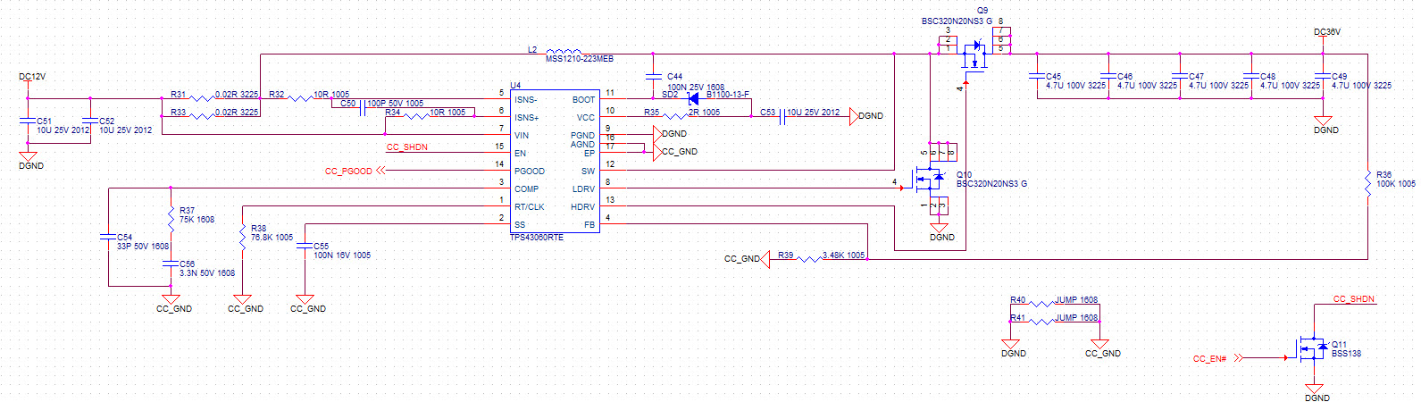

I've designed with TPS43060 based on webench.
Vin : 12V
Vout : 36V
When EN pin is float, output is around 36V
But, when I connect EN pin to GND, output is not going zero.
It shows around 12V (11.8xxV).
In that state,
VCC (Pin 10) : 0.389V
BOOT (Pin 11) : 12V
HDRV (Pin 13) : 11.746V
LDRV (Pin 8) : 0V
In my thought, HDVR have to go zero but it is too high.
What's wrong in my schematic?
  • Hi Jeong,
    This is normal for boost converters. When the part is not switching there is a direct path from VIN to VOUT through the current sense resistors, inductor and body diode of the high-side MOSFET. When the part is disabled the output will be slightly below VIN. If this needs to be avoided with your application, an external load disconnect switch would be needed on the input. Alternatively some other controllers integrate a gate driver for a load disconnect switch on the input.
    Anthony
