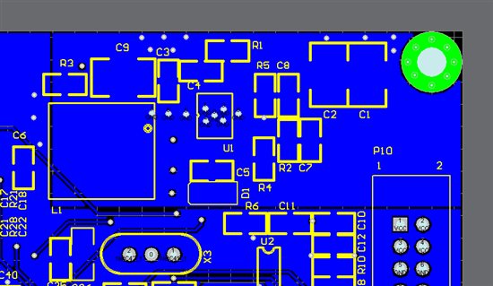

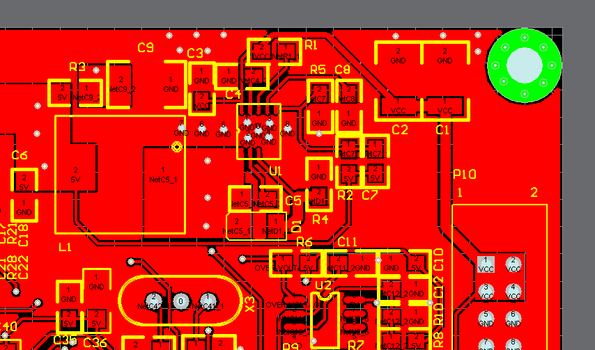

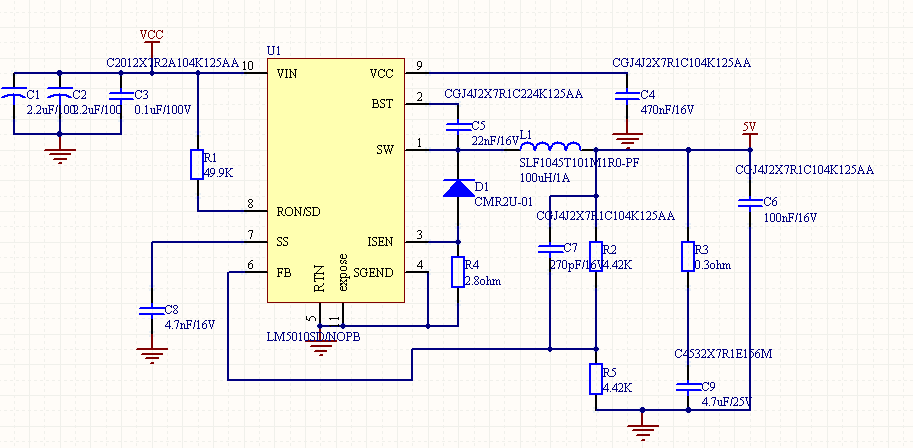

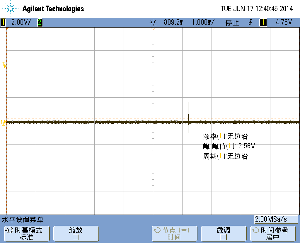

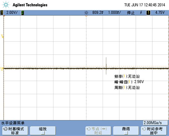

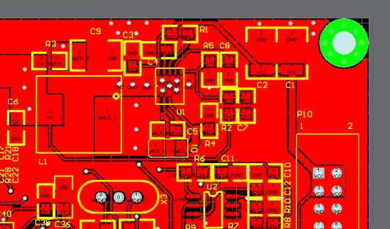

I use LM5010SD/NOPB for application  48V in and 5V out .
The problem is I can't detect any signal from the IC,except VIN and RON/SD pin have 48V,and SW have a pulse when power on.
And the VCC is also not have any signal out.
Thank you!
over 11 years ago
  • Cancel
  • Gao Long
    0 Gao Long over 11 years ago
    Prodigy 20 points
    And I also experiment the circuit from Webench. It has the same result.

    Hi Gao,
    From the description, I can't tell what the problem might be. I will try swapping the part or ensuring it is soldered properly. Atleast VCC should come up before we talk about other signals.
