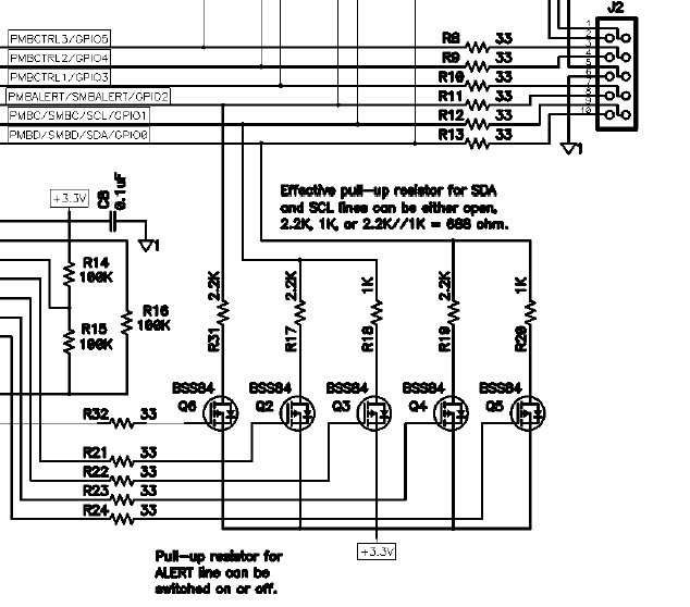

Dear all,
I would like to use a bq24261 to charge a battery. It is not fully clear to me which is the voltage required for the I2C interface: in the datasheet it seems to be tested at V(scl) = V(sda) = 1.8 V, but I do not find a max-min voltage to bias them. Does it work if I connect it to a master providing V(scl) = V(sda) = 3.3V?
