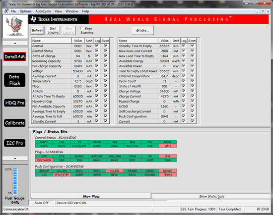

    1 - I've used the bqEVSW for unsealing the pack (accordingly to the procedure already reported in my first post). After such a procedure, the screenshot of bqEVSW confirms the pack has been unsealed (and also I can read the data flash):

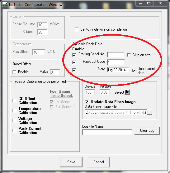

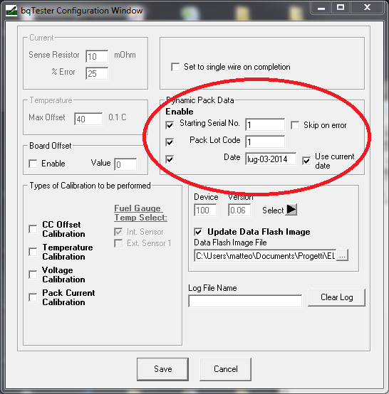

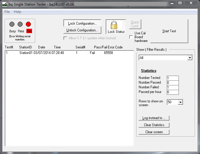

    2 - I've used the bq Single Station Tester to transfer the golden rom file on the unsealed device. First of all, I've configured the manufacturing data accordingly to the following screenshot:

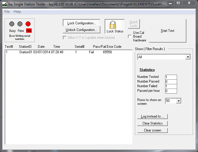

    Then I've launched the test, but it hasn't been passed:
    And the error code 65558 means (from bqMTester user manual): "Failed to write manufacturer data".

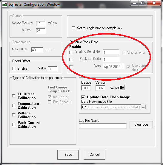

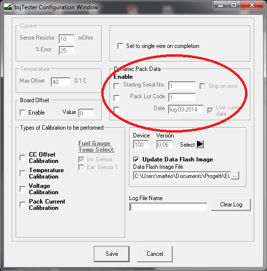

    4 - I've used again the bq Single Station Tester. In this case I've disabled all Dynamic Pack Data (i.e. manufacturing data):

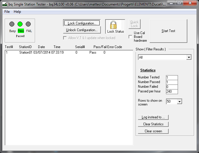

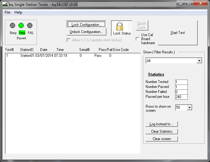

    And in this case the test has been passed:

  • I re-verified that you can write the Manufacturer Data to an Unseal Device that was previously Sealed. The problem is that you cannot perform the load ROM and update the parameters in the same test. The bqMTester must reset the device after performing one of the functions and this seals the device and prevents the other task from writing to flash. You can perform both functions in the same test, if the device has never been sealed.
