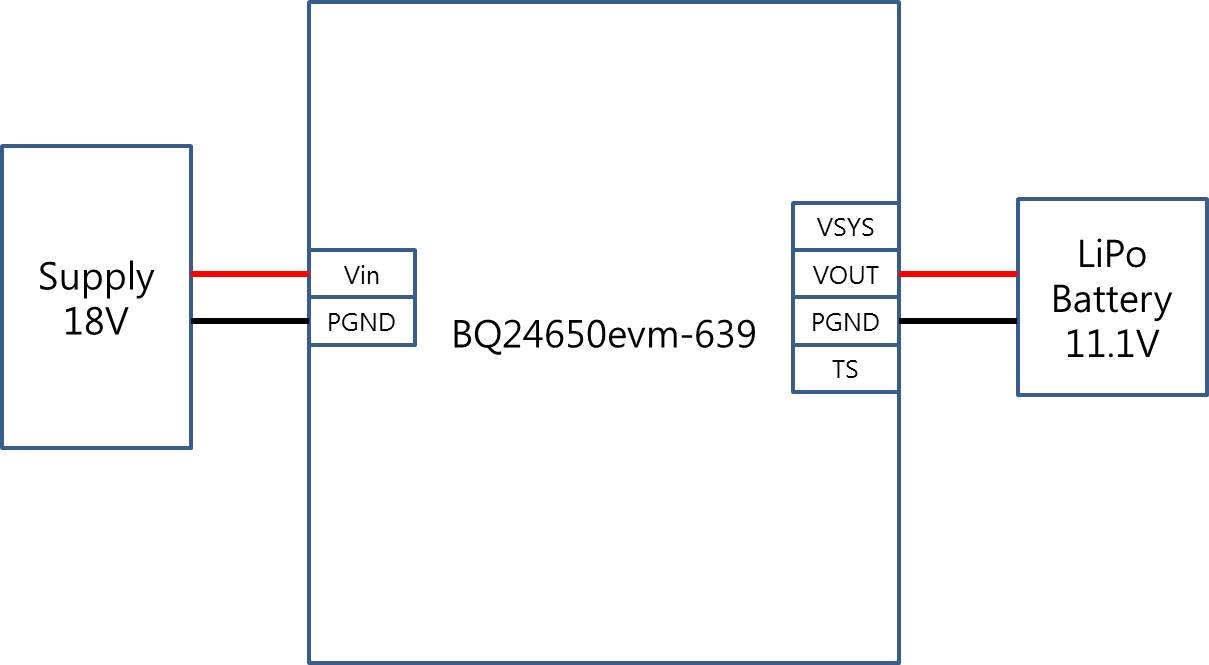

I have a solar module(18V, Short Circuit current 4A)
I want to charge LiPo 11.1V battery.
So, I have connected for test as follow.
                [Supply 18V] - [BQ24650evm-639] - [LiPo 11.1V battery]
We  obtained 12.6V and almost 0A..
We can't obtain 2A..
How to obtain 2A?
And We want to increase 4A about charge current.
How to change 4A? only change R6???

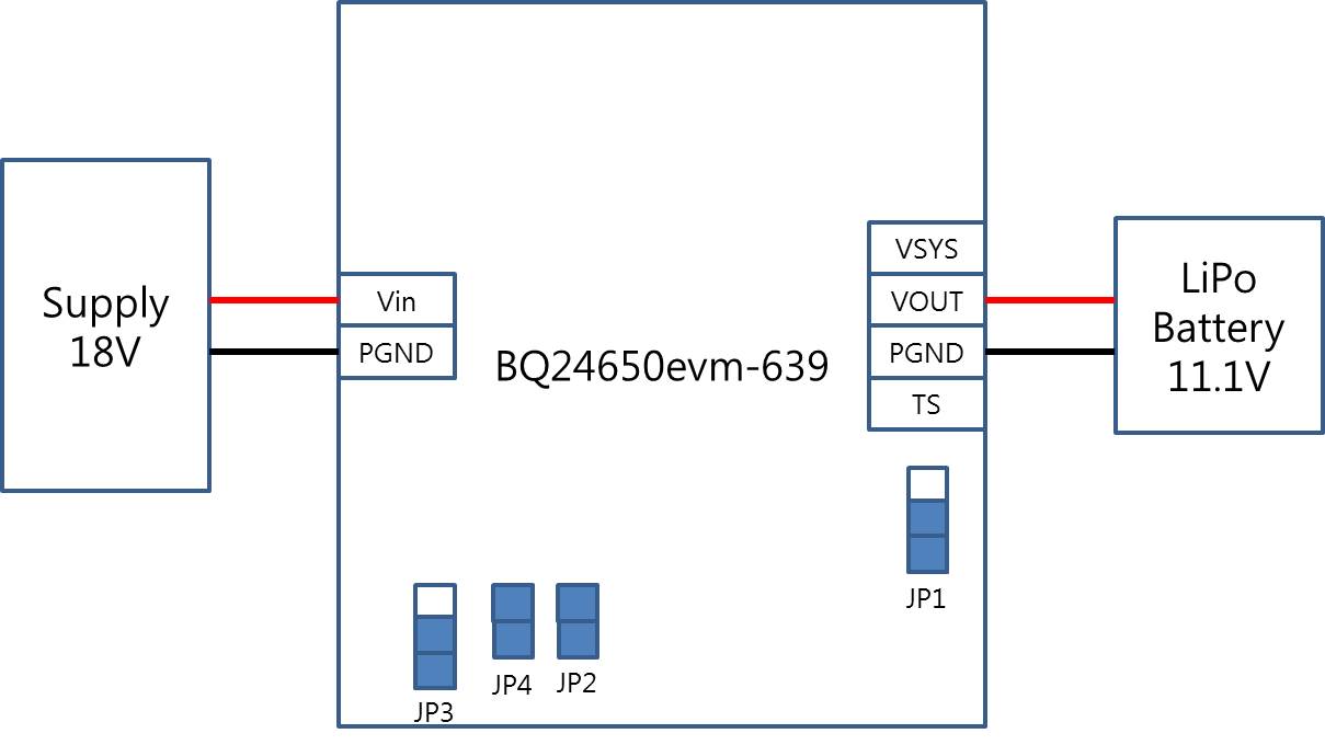

    I set Jumper position as follow.
    JP1(TS-Internal), JP2(On), JP3(TERM EN-DIS) JP4(On)
    When I supply input voltage (18V), D4(STAT1) led is on and D5(STAT2) led is off.
    This setting is wrong???

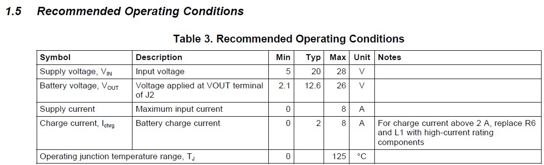

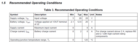

  • Hello Hyeon-Bo,
    First I will talk about the inductor selection. The datasheet for the BW24650 discusses the output filter components on Pg. 17 here is a screen shot of them below. Two key characteristics  that the inductor must have is at least the recommended inductance and that it is rated to handle the expected continuous charging current with some head room.
    I do not see anything in your jumper configurations that would immediately suggest it should not be charging. So you are seeing 12.6V on the output?
    The datasheet provides a listing of criteria on Pg. 14 that must exist for charging to occur. Have you run through testing these values?

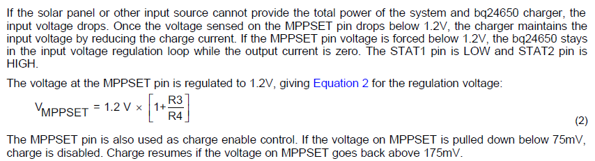

  • Hello Hyeon-Bo,
    The fact that it is working at one voltage input and not the other I am thinking it might be related to the MPPT on the input. What is the voltage at the input to the EVM when you achieve charging?
    It is possible that the voltage sensed on the input of the  chip is low enough that the MPPT algorithm places the chip in a non-charging state.
    Try measuring the voltage on the input and at the MPPSET test point.

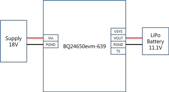

  • Hello Ryan,
    I want to charge when I supply input voltage 18V.
    Because, My solar module generate 17~19V.
     And I conducted 2 test.
    First, I connect Power Supply for input voltage.
    Second, I connect my solar module.
    I obtained same result.
    When I supply below 18V, It doesn't charge.
    But, above 18V, start to charge.
    And When I supply 18V, MPPSET pin voltage  is about 1.1V.
    When I supply About 20V, MPPSET pin voltage is 1.2V.
    STAT1 LED is always on when I supply above 5V inputvoltage.
    So I think, above 18V is operation voltage for charge.
    What do you think of this situation??
