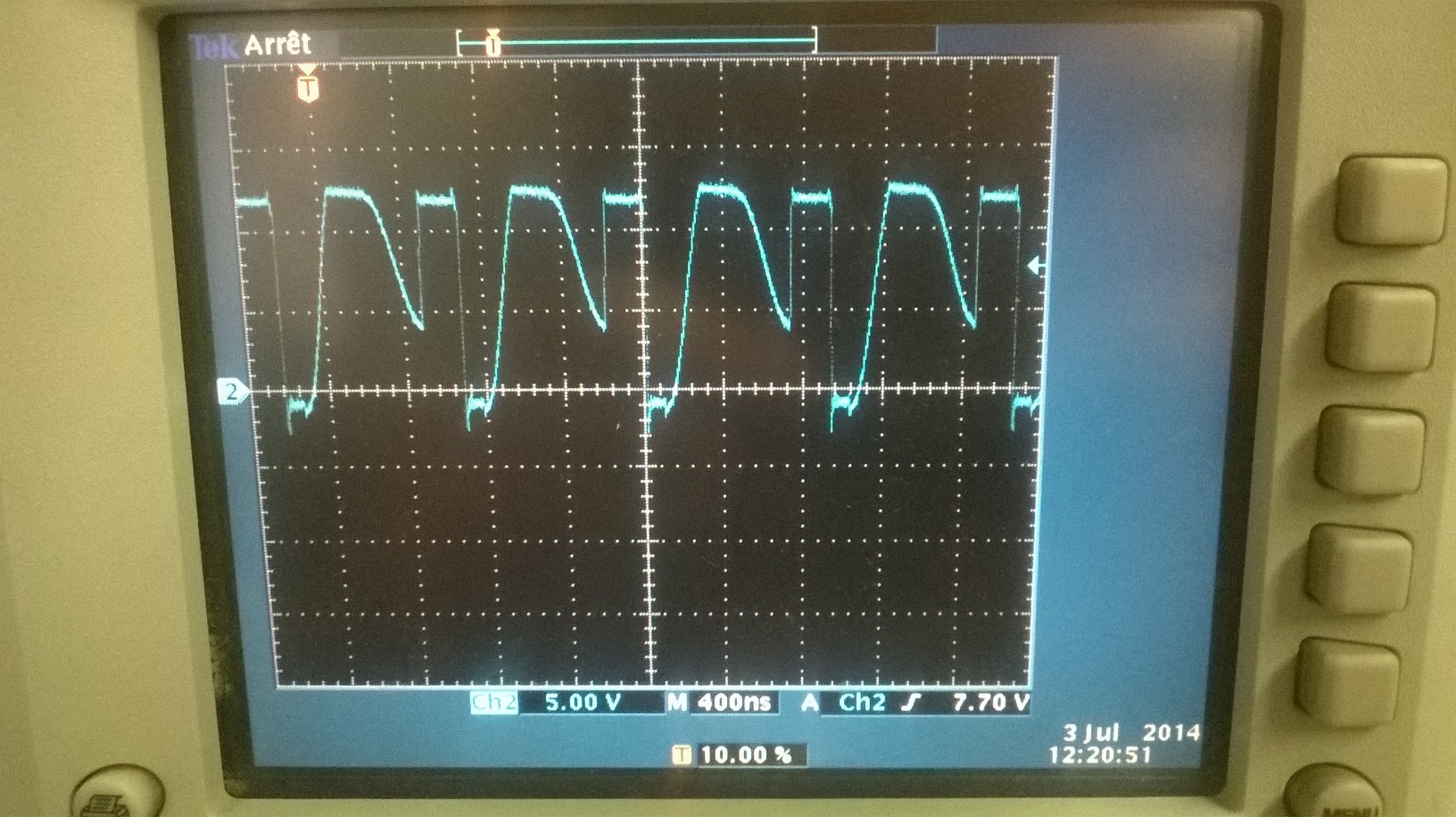

    In addition, when there is no battery connected and when i enable charge, STAT1 must be OFF (Table 1).
    But STAT1 is ON in my case ...
    Below screen of BAT level when charge enable and battery not connected :
  • Hello Florent,
    Sorry for the delay.
    That is strange that you are seeing a waveform that is similar to the battery detection waveform when you using the BQ24115 which does not have the integrated detection algorithm as discusses on Pgs. 19-20
    Since there is no battery detect on the BQ24115 it makes sense that when charging is enabled it will attempt to charge and it will indicate that it is trying to charge.
    Is there anything else present on the battery rail when your simulated battery is disconnected?
